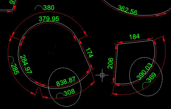

m4rdy Posted December 1, 2009 Share Posted December 1, 2009 Hi all, How can i use the command DIMARC on all arc's polyline segment(s) without picking the segment(s) and dimension location? One more thing the dimensions have to be associative's. Thank you for any helps. M4rdy. Autocad 2007 Quote Link to comment Share on other sites More sharing options...

fixo Posted December 1, 2009 Share Posted December 1, 2009 And one more thing, i found error on different UCS angle.Command: DMP >> Select pline >> ; error: bad argument type: numberp: nil M4rdy Hi Mardy I figured out how to get it to work in the different UCS just added few lines of code Let me know how it will be work ~'J'~ DimPoly.LSP Quote Link to comment Share on other sites More sharing options...
m4rdy Posted December 2, 2009 Author Share Posted December 2, 2009 It works perfectly. Just curious, why do you use dimangular (vla-adddim3pointangular) then override the text for arc segments? I've tried to use dimarc, but i had no luck. What's wrong with that? Thank you sir. m4rdy Quote Link to comment Share on other sites More sharing options...

fixo Posted December 2, 2009 Share Posted December 2, 2009 Wait a minute...FIXO i have a little problem with your dmp. If the arc segment as the last segment on closed pline, the result goes wrong. Hi Wizman, How are you doing? Did you finish your 'future addition'? I see (acdimenableupdate T) works for STRETCH command, but it doesn't for GRIP edit. m4rdy I have added both dimensioning for bulged segments - angle dimension and arc dimension Try again ~'J'~ DimPoly.LSP Quote Link to comment Share on other sites More sharing options...
wizman Posted December 2, 2009 Share Posted December 2, 2009 Wait a minute...FIXO i have a little problem with your dmp. If the arc segment as the last segment on closed pline, the result goes wrong. Hi Wizman, How are you doing? Did you finish your 'future addition'? I see (acdimenableupdate T) works for STRETCH command, but it doesn't for GRIP edit. m4rdy Doing fine here Mardy, Here's my latest Mdim.Lsp. MDim_02DEC09.lsp Quote Link to comment Share on other sites More sharing options...
m4rdy Posted December 2, 2009 Author Share Posted December 2, 2009 Hi FIXO, Till now your routine works well. Thank you for your kindness, sir. Wizman, as always ..many thanks (..again..and ..again). m4rdy Quote Link to comment Share on other sites More sharing options...
