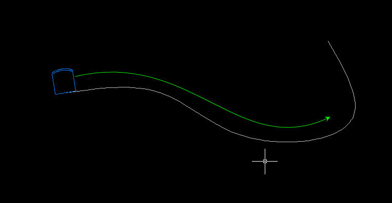

gpktm Posted August 8, 2008 Share Posted August 8, 2008 I have a path (not common shapes) and I want to array the objects along the path. How can be done? I'm using ACAD2006 but I have 2008 at work also. Thanks in advance. Quote Link to comment Share on other sites More sharing options...
lpseifert Posted August 8, 2008 Share Posted August 8, 2008 make the object a block, use Measure or Divide (use option 'Align block with object') Quote Link to comment Share on other sites More sharing options...

gpktm Posted August 8, 2008 Author Share Posted August 8, 2008 make the object a block, use Measure or Divide (use option 'Align block with object') Thanks! That worked fine! I learned something new after 5yrs Quote Link to comment Share on other sites More sharing options...
