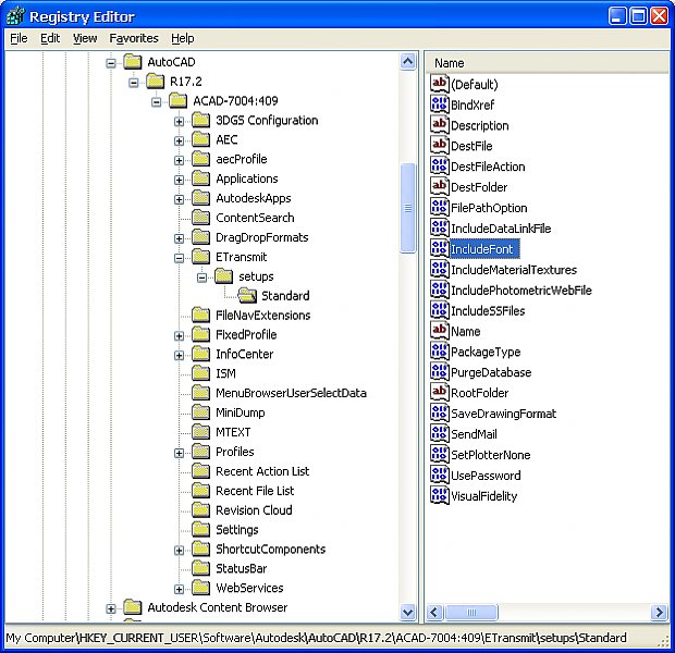

Does anyone know If it's possible to create an etransmit profile including fonts via lisp?
The include fonts is an option you can mark inside the dialog box when creating a new e-transmit profile, but this option is not available using the old-fashioned -etransmit command (otherwise I could do it myself)... but is it possible to create the whole profile including this option by just typing the lisp abbreviation?..
Otherwise, where are the profile "files" stored in autocad directories so I could keep my profile whenever I reinstall autocad?
Looks like Etransmit setups are stored in the Windows Registry. Use Windows RegEdit command to view. Bottom line of photo below shows the path. Take a look at VLisp functions 'vl-registry-read and 'vl-registry-write. Be careful with editing the Registry and backup your profile before editing!
[ATTACH]16135[/ATTACH]

Great, Steve.
It sounds possible with this info... I will check it out later using another similar lisp I got.
