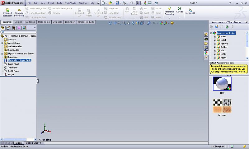

sirhk100 Posted June 28, 2010 Share Posted June 28, 2010 Under Metal>Steel I know there is a chain link material. Under Misc there are some checker and waffle patterns that might give the visual you are looking for if you are just trying to differentiate while modeling. Under Ruber>Texture there is a perforated rubber that you can alter that might be close as well. Like i said if you have a specific wire mesh in mind you will probably have to make it yourself. I'm working on 2010 and under my materials on the tree, right click, edit materials... Brings up the extensive list and there's nothing similar to this. Did they change this for 2010? Anyone know? Quote Link to comment Share on other sites More sharing options...

bhamze Posted June 29, 2010 Share Posted June 29, 2010 I'm working on 2010 and under my materials on the tree, right click, edit materials... Brings up the extensive list and there's nothing similar to this. Did they change this for 2010? Anyone know? Are you selecting a material in the feature tree or in the appearance tab? Take a look at screen shot, the appearance tab is located on the right. This is what you want to select to apply an appearance or texture. Quote Link to comment Share on other sites More sharing options...
sirhk100 Posted June 29, 2010 Share Posted June 29, 2010 Ahhhh... Yes!!! Thank you... I was trying to edit the physical material over in the tree, not on the appearances window. I appreciate it! Khris Quote Link to comment Share on other sites More sharing options...
