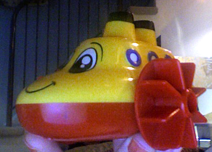

roxstargh Posted December 14, 2009 Share Posted December 14, 2009 Hello, I am new to solidworks and I am getting an error message that says that it cannot complete the loft because of intersecting lines. Basically I have shapes that look like elongated D's. The first shape I drew on the top plane then created a new plane and offset it about .5" from the first shape and then used "offset entity" and minimized the sketch approximately .10". Then I created another plane and drew another elongated D that is much smaller than the first and then repeated the steps making a new plane and then offsetting the entity to about .10". The first sketch and the third sketch (the ones that are not offsets) are able to loft. Is there an issue with using offset entity? I did not want to have to redraw the same shape since it is basically the same size. Thanks so much for your help! Quote Link to comment Share on other sites More sharing options...
JD Mather Posted December 14, 2009 Share Posted December 14, 2009 Can you attach the file here? Not sure but it sounds like you shouldn't offset the sketch - but rather, Loft without offsetting and then Shell. Quote Link to comment Share on other sites More sharing options...
shift1313 Posted December 14, 2009 Share Posted December 14, 2009 If you have a consistent offset can this be done with extrude and a draft? To me it sounds like your sketch where you offset entities, you left the original sketch and did not make it a construction. When you Offset, there is a check box that says "make base construction". Make sure if you do not want to include those lines that they are made construction lines. Quote Link to comment Share on other sites More sharing options...

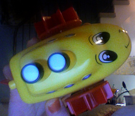

roxstargh Posted December 14, 2009 Author Share Posted December 14, 2009 It is really my lack of knowledge for what is available, I think. If it were a solid part I would do an extrude and fillet the parts but because it needs to be a thin feature I am not so sure. This is what I am trying to model (see pic). Do I need to make 3d curves when using loft? Quote Link to comment Share on other sites More sharing options...
JD Mather Posted December 14, 2009 Share Posted December 14, 2009 I can't quite tell from your picture but try to do an Extrude (just to test) on each one of your sketches. Will it allow you to extrude without picking multiple contours in the sketches. BTW - the picture you posted is a solid part. I would most likely use Shell to get the part(s). Might require some surface body construction/editing, but the end result would be a solid body. In my signature is a link to some surfacing tutorials - they are a little out-of-date but might be of some use. Can you zip and attach the file here> Quote Link to comment Share on other sites More sharing options...
roxstargh Posted December 14, 2009 Author Share Posted December 14, 2009 You are right. the extrude then shell feature is the way to go. I guess I just figured it would be easier to do in one sweep. Thanks for your help!!! I am going to practice some of your tutorials. Quote Link to comment Share on other sites More sharing options...
JD Mather Posted December 14, 2009 Share Posted December 14, 2009 No, no, no that isn't what I meant. I think Loft and Shell is the way to go. I was just trying to show you a way to pinpoint sketch problems by testing them with Extrude. Quote Link to comment Share on other sites More sharing options...
