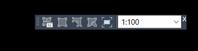

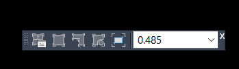

BIGAL Posted April 29, 2021 Share Posted April 29, 2021 (edited) Open the Viewports toolbar it has a current scale indicator so can tell straight away, as your metric its real helpful, go into a viewport zoom etc, will see a number appear in the toolbar type 10 in that box that is 1:100 it is found by 1000/scale so 1000/100 = 10 1000/250 = 4 Edited April 29, 2021 by BIGAL Quote Link to comment Share on other sites More sharing options...
