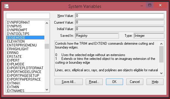

steeldesigner Posted April 10, 2015 Share Posted April 10, 2015 when i try to trim with enter enter it trims little microscopic pieces off of the line, its so frustrating, it is a big deal because i go pretty fast on autocad, and when i have to stop, reenter the trim command, zoom up really close and pick the cutting edge, then pick the trim part is ridiculous, I havent trimmed a line by picking the cutting edge first in 12 years, i cant go backwards, i know it is a system variable, i just cant find it, Does anyone know how to fix this? Quote Link to comment Share on other sites More sharing options...

Dadgad Posted April 10, 2015 Share Posted April 10, 2015 Sounds like your EDGEMODE system variable. As described in the screenshot. Quote Link to comment Share on other sites More sharing options...
Dadgad Posted April 10, 2015 Share Posted April 10, 2015 (edited) edgemode, thats it!!! BUT NOW THE REAL QUESTION IS....HOW DID ALL, OR A LOT OF MY SYSTEM VARIABLES GET RESET? EDGEMODE WAS RESET, PICKADD, WAS RESET, PICKFIRST WAS RESET, AND LIKE 3 OR 4 OTHERS, WHY DID THIS HAPPEN, NOBODY USES MY COMPUTER BUT ME, IM THE ONLY ONE IN MY FAMILY THAT KNOWS HOW TO USE AUTOCAD, HOW DO SYSTEM VARIABLES MYSTERIOUSLY GET RESET OR SET TO DIFFERENT NUMBERS? ITS REALLY FRUSTRATING WHEN YOU DONT KNOW WHICH ONES THEY ARE. THE ONE CALLED PICKFIRST GOT RESET, IM ALWAYS USED TO BEING ABLE TO SELECT OBJECTS FIRST, AND THEN THE COMMAND, NOT SO IF PICKFIRST IS RESET.... Likely a poorly written lisp, which when closed or aborted, failed to restore your previous system variable settings. Do you see the Save All button in the bottom of my screenshot of the SYSVDLG box? It is a very good idea to SAVE an .svf (system variable file), which contains all of your prefered settings, for just such an eventuality. For those who use the Autocad OOTB default system variable settings (does anybody really do that?), they can be restored by using the Read button. Edited April 10, 2015 by Dadgad Quote Link to comment Share on other sites More sharing options...
RobDraw Posted April 10, 2015 Share Posted April 10, 2015 BUT NOW THE REAL QUESTION IS....HOW DID ALL, OR A LOT OF MY SYSTEM VARIABLES GET RESET?... HOW DO SYSTEM VARIABLES MYSTERIOUSLY GET RESET OR SET TO DIFFERENT NUMBERS? The real question is, what were YOU doing when the variables changed? Was there a crash? Do you use LISP and possibly did not finish the routine gracefully, i.e. hit Esc before finishing the command? Quote Link to comment Share on other sites More sharing options...
steeldesigner Posted April 10, 2015 Share Posted April 10, 2015 Sounds like your EDGEMODE system variable.As described in the screenshot. YES, THANKS IT WAS EDGEMODE, I KNEW IT WAS A SYSTEM VARIABLE I JUST COULDN'T REMEMBER WHAT IT WAS CALLED, I TRIED TO USE THE HELP MENU AND IT BROUGHT UP EVERYTHING BUT EDGEMODE. HOW DO YOU BRING UP THE DIALOG BOX OF ALL THE SYSTEM VARiables? thanks Quote Link to comment Share on other sites More sharing options...

ReMark Posted April 10, 2015 Share Posted April 10, 2015 One way is to type SYSVDLG at the command line then hit Enter. Another way is from Express Tools > Tools. Quote Link to comment Share on other sites More sharing options...
neophoible Posted April 10, 2015 Share Posted April 10, 2015 If you have Express Tools installed, Command: _.sysvdlg Oh, well; refresh didn't catch the Remark remark for me. So, what's new? Quote Link to comment Share on other sites More sharing options...
