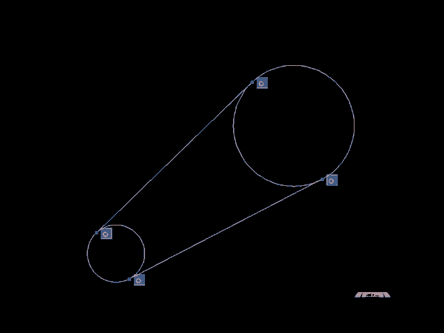

LEsq Posted December 20, 2009 Share Posted December 20, 2009 LE is that the tangential geometric constraint in ACAD_2010?. Nope. It is an small app in ARX/Custom Object And probably what these adesk guys used to write that new feature available in a2010, that by the way I have but so far don't have the chance to installed nor to try it Quote Link to comment Share on other sites More sharing options...

wizman Posted December 20, 2009 Share Posted December 20, 2009 Nope. It is an small app in ARX/Custom Object And probably what these adesk guys used to write that new feature available in a2010, that by the way I have but so far don't have the chance to installed nor to try it Here's tangent geometric constraint in action, works similar. Tangents are drawn manually then when autoconstraint is applied, this is the result. Quote Link to comment Share on other sites More sharing options...
LEsq Posted December 20, 2009 Share Posted December 20, 2009 Here's tangent geometric constraint in action, works similar. Tangents are drawn manually then when autoconstraint is applied, this is the result. There you go - they copy me.... I been doing these type of apps about 7 years ago.... Interesting... Quote Link to comment Share on other sites More sharing options...

LEsq Posted December 20, 2009 Share Posted December 20, 2009 No doubt about that Master LE...'-) just LE.. Just for curiosity purposes, when you apply those constrains, all those objects become like a group?... or in other words, if you copy from one it brings all the rest of that group? Or someone have to apply the constrains as per selection basis. Clear as mud? Thanks. Quote Link to comment Share on other sites More sharing options...
wizman Posted December 20, 2009 Share Posted December 20, 2009 i just had a quick try sir, no they are not becoming as a group, when i copy either a line or a circle, only the selected entities are copied. When i move any one then all are moving/stretching. And when i delete a line or a circle, the remaining constraints are still working. As for the selection, i just did a window selection on the four entites, then applied Parametric>Autoconstrain. Quote Link to comment Share on other sites More sharing options...
LEsq Posted December 20, 2009 Share Posted December 20, 2009 i just had a quick try sir, no they are not becoming as a group, when i copy either a line or a circle, only the selected entities are copied. When i move any one then all are moving/stretching. And when i delete a line or a circle, the remaining constraints are still working. As for the selection, i just did a window selection on the four entites, then applied Parametric>Autoconstrain. Thank you Wizman. Quote Link to comment Share on other sites More sharing options...

wizman Posted December 21, 2009 Share Posted December 21, 2009 Thank you Wizman. You're welcome LE. I've been trying to make it work in 3D Belt Mech but no luck cant figure how to link the motion. Ive seen one before done on JTB site. It's a cool new tool, what more when constraints are applied to dynamic blocks. Here's an interesting read from Autodesk. http://au.autodesk.com/ama/images/media/AU09_SpeakerHandout_AU318-1.pdf Quote Link to comment Share on other sites More sharing options...
