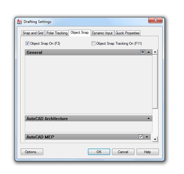

curti5 Posted December 20, 2009 Posted December 20, 2009 I am running AMEP 2010 with Windows 7. I downloaded MEP 2010 from a link my teacher gave me to the AutoDesk site so I have no disc. I can shift right click and pick specific osnaps but the running osnaps are all missing from the drafting settings dialog box. The DS dialog box has three areas to list osnaps, General, AutoCAD Arch and ACAD MEP. All three areas are blank. Anyone have this problem? If this is a download issue, is there a repair function available through AutoDesk? Quote

tzframpton Posted December 20, 2009 Posted December 20, 2009 The Trial and Educational versions are the exact some content from the disc... only packaged up into one down-loadable installer as far as I know. The problem might be Windows 7, but who knows. That's a very weird error. Can you post a screenshot of the Drafting Settings dialog box just so I can see the error? Quote

curti5 Posted December 22, 2009 Author Posted December 22, 2009 I tried changing the profile (in the "options" dialog box and profiles tab) to AutoCAD Classic and then change my Workspace settings on the drawing task bar to AutoCAD and the object snaps show up like they are supposed to (Shift, right click on Osnap button, settings, then the drafting settings dialog box with the osnaps selection appears) but when I return to MEP profile and MEP workspace they are missing again. Sorry this is taking so long but I've been trying to figure out snagit and it will only save a txt file not an image unless I spend $50.00. As far as your other instructions I do not know how to turn what is on my clipboard into a BMP file. I appreciate you sticking with this LEsq, as you can see only you and StykFacE have the patience. Quote

curti5 Posted December 22, 2009 Author Posted December 22, 2009 While your were posting I got a jpg of my empty drafting settings dialog box. Anything bigger and it would have been over the kb limit. Anyway, thanks for your help and happy holidays. Alan Quote
tzframpton Posted December 23, 2009 Posted December 23, 2009 Voilá! Looks like there's a known issue and currently a fix is in the works: http://usa.autodesk.com/adsk/servlet/ps/dl/item?siteID=123112&id=14056444&linkID=9240657 I guess just hang tight until they release a hotfix and/or service pack. Or from what they're saying it might be a video hardware issue, so follow their steps and/or check to make sure your graphics card has a tested and certified driver available on their graphics hardware support list. Just keep checking in about once a week until there's a fix. One thing to do, is to keep the MEP Snaps all turned on (I'm assuming you can simply because in your screenshot the box is checked in the AutoCAD MEP section) and then learn your OSMODE number. Or try and set it by right-clicking the OSNAP button at the bottom left of the AutoCAD MEP interface, as shown below in the screenshot: This will at least be a work around until the issue gets resolved. Quote
