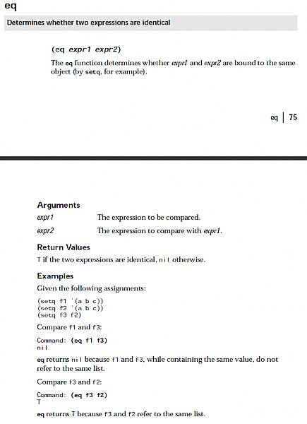

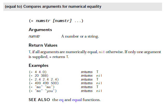

muthu123 Posted December 21, 2009 Posted December 21, 2009 anybody can explain the difference between the following functions? = eq equal I have to compare lists which may have sublists. which function is correct? explain. Quote
alanjt Posted December 21, 2009 Posted December 21, 2009 Sublists are going to force you into a little more work. Quote
Lee Mac Posted December 21, 2009 Posted December 21, 2009 Some more info here: http://www.theswamp.org/index.php?topic=29839.msg354144#msg354144 Quote
