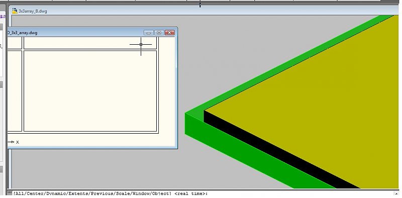

i mean "to Solid".... i've got empty gutters i created with a rect array & an offset. i need them to be a solid object, not empty space. Searched this site & help & Dummy (i will take Dummy back-- maybe get Finklestein) I tried LOFT & now I'm back to using 3dFACE, but I don't have it yet. any thoughts or suggestions appreciated. thanx much!
Try to create an other solid that completely overlaps this one and do a SUBTRACT
thanks much, mr. fuccaro. i have to move on to other tasks for the moment but i will let you know how that works out. btw, that is a lovely horse. nice pic.
