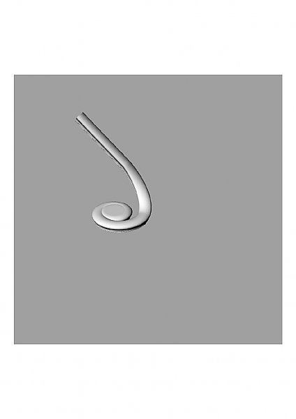

Arnie Posted December 26, 2009 Share Posted December 26, 2009 I am new to inventor and would appreciate any advice on how to make this scroll handrail with inventor . Quote Link to comment Share on other sites More sharing options...

Arnie Posted December 30, 2009 Author Share Posted December 30, 2009 Hey JD Would you mind telling me how you made it with sweep as the command doesn´t allow the section to be swept to overlap ? The straight part of the handrail is supposed to be at 40 degrees in relation to the curly bit , that's where the 3D curve is necessary. Thanks Quote Link to comment Share on other sites More sharing options...
Arnie Posted December 30, 2009 Author Share Posted December 30, 2009 If you look carefully at the picture, you will notice the shadow below the straight part . Thanks again Quote Link to comment Share on other sites More sharing options...
JD Mather Posted December 30, 2009 Share Posted December 30, 2009 If you look carefully at the picture, you will notice the shadow below the straight part .Thanks again A top, front, side view might have helped me see the geometry better. I couldn't tell that it was curving up away from the table in the shot you posted. In any case, this would be a challenging part for a beginner. I takes a bit of knowledge of surface modeling, 3D Sketch intersections and Loft with Rails. Quote Link to comment Share on other sites More sharing options...

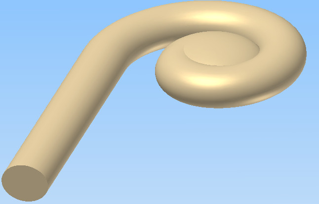

jel Posted January 3, 2010 Share Posted January 3, 2010 Sorry only been playing with cad for a couple of months, but not sure if this is something close to what you are looking for, needs some tidying up! if this is the sort of thing you want I will try to explain further how I created it. Quote Link to comment Share on other sites More sharing options...
Arnie Posted January 4, 2010 Author Share Posted January 4, 2010 Sorry only been playing with cad for a couple of months, but not sure if this is something close to what you are looking for, needs some tidying up! if this is the sort of thing you want I will try to explain further how I created it. Hey Jel. That's exactly what iam trying to get. Could you break it down to me , please ? The only point I woud make would be that the curve should start a litle earlier , basicaly where the curly bit finishes, like a 3D curve. Thanks Quote Link to comment Share on other sites More sharing options...

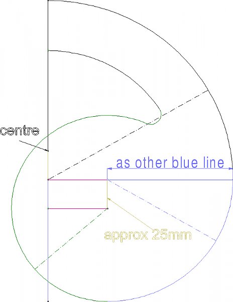

jel Posted January 4, 2010 Share Posted January 4, 2010 I constructed this from three parts 1. the wreathing part leading into the monkey tail. (3d but drawn 2d and rotated) 2. the spiral part 3. A bun to sit in the middle of the spiral 1. draw a triangle with the correct pitch as the hypotenuse. the horizontal line (or going) is the minor axis of an ellipse, the hypot is the major axis. create this and select the quadrant you want. 2. create a 2d spiral to suit the size of "D" tread you are working with. and take it round about .75 of a turn. 3. move the quadrant of the ellipse so the minor axis end connects to the outeer part of the spiral, then lift the major axis end of that quadrant upto pitch. this will now be circular from the plan view. 4. join these two parts together. locate an outline of your handrail profile over top of one end of this line and sweep rail. 5. finaly create a circle to sit inside the spiral cut your profile in half and rotate around the circle to create the "bun" part of the monkey tail. you may have to play with this a bit to get the proportions looking right. hopefully that all makes sense, or gives you a guiding hand to find the solution. The wreathing part stops at 90º on my drawing ( which would be the front of the tread) if you want it to travel further it gets a bit more complicated as you can not just tip an ellipse up to pitch, you will have a wreathing part that is going from pitch to pitch rather than pitch to horizontal. this then becomes a job on its own to create that wreathing part. Quote Link to comment Share on other sites More sharing options...

jel Posted January 4, 2010 Share Posted January 4, 2010 Here is one way of geometrically drawing a monkey tail, then you can attach the wreathing part to it. Quote Link to comment Share on other sites More sharing options...
Arnie Posted January 4, 2010 Author Share Posted January 4, 2010 I constructed this from three parts The wreathing part stops at 90º on my drawing ( which would be the front of the tread) if you want it to travel further it gets a bit more complicated as you can not just tip an ellipse up to pitch, you will have a wreathing part that is going from pitch to pitch rather than pitch to horizontal. this then becomes a job on its own to create that wreathing part. Hey Jel Thanks for all . Unfortunately it does need to travel that much further and that's exactly the problem ( 3D curve ). BUt thanks for the help Quote Link to comment Share on other sites More sharing options...
