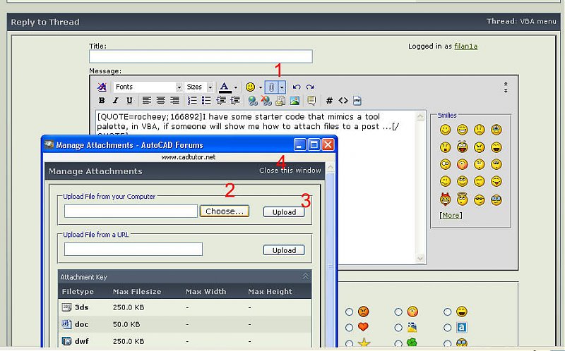

I have some starter code that mimics a tool palette, in VBA, if someone will show me how to attach files to a post ...
look at the picture:
During reply: follow the order of the numbers.
