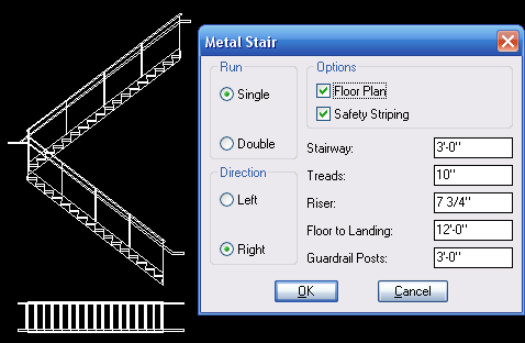

LEsq Posted January 12, 2010 Author Share Posted January 12, 2010 MTLSTAIR Draws a floor plan and section of a metal stair following UBC code. Included the ugliest source code but helpful back then - in the zip file, I wrote this routine, when was working on a high rise project (32 stories bulding hotel) and in charge of all the stairs analysis. mtlstair.zip Quote Link to comment Share on other sites More sharing options...

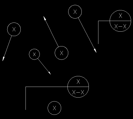

LEsq Posted January 15, 2010 Author Share Posted January 15, 2010 REACTORSWIZ A way to control visual lisp object reactors. Routines samples included that generates a detail, keynote and a circle bubble symbols. Some controls or features are: - Position control of attributes. - Assign one of the objects to control the copy when this object it is copied it will create a new symbol and add it to the same reactor. - When one object from the symbol it is erased, the whole symbol will be erased too. Hope it will make some sense... Partial code sample.- (all the source code and vlisp .prj it is inside the attached zip) ;;LE ;; degrees (setq :rwiz_45degrees (* pi 0.25)) (setq :rwiz_90degrees (* pi 0.5)) (setq :rwiz_135degrees (* pi 0.75)) (setq :rwiz_225degrees (* pi 1.25)) (setq :rwiz_270degrees (* pi 1.5)) (setq :rwiz_315degrees (* pi 1.75)) (setq :rwiz_360degrees (* pi 2.0)) ;;;_____________________________________________________________ ;; get acad object object ;; LE (if (not :rwiz_acad) (setq :rwiz_acad (vlax-get-acad-object))) ;;;_____________________________________________________________ ;;; get active drawing object ;;; LE (defun rwiz-thisdwg () (vla-get-activedocument :rwiz_acad)) ;; global variable for this drawing ;; LE ;;;(or :rwiz_thisdwg (setq :rwiz_thisdwg (rwiz-thisdwg))) (setq :rwiz_thisdwg (cond (:rwiz_thisdwg) ((rwiz-thisdwg)) (t (rwiz-thisdwg)))) ;;;_____________________________________________________________ ;; get model space object ;; LE (if (not :rwiz_model) (setq :rwiz_model (vla-get-modelspace (rwiz-thisdwg)))) ;;;_____________________________________________________________ ;;; get paper space object ;;; LE (defun rwiz-pspace () (vla-get-paperspace (rwiz-thisdwg))) ;;;_____________________________________________________________ ;;; get active space object (defun rwiz-get-activespace () (if (= acmodelspace (vla-get-activespace (rwiz-thisdwg))) :rwiz_model (if (= (vla-get-mspace (rwiz-thisdwg)) :vlax-true) :rwiz_model (rwiz-pspace)))) ;;;_____________________________________________________________ ;;; get active space name "Model" or "Paper" (defun rwiz-activespacename () (cond ((= acmodelspace (vla-get-activespace (rwiz-thisdwg))) "Model") (t (if (= (vla-get-mspace (rwiz-thisdwg)) :vlax-true) "Model" "Paper")))) ;;;_____________________________________________________________ ;;; adjust dimscale, it will use 1.0 factor when is in paper space ;;; sc = scale factor as real ;;; LE (defun rwiz-adjust-dimscale (sc) (if (= (rwiz-activespacename) "Model") sc 1.0)) ;;;_____________________________________________________________ ;;; list to variant array ;;; ptslist = point list (defun rwiz-list-variantarray (ptslist / arrayspace sarray) (setq arrayspace (vlax-make-safearray ;; element type vlax-vbdouble ;; array dimension (cons 0 (- (length ptslist) 1)))) (setq sarray (vlax-safearray-fill arrayspace ptslist)) ;; return array variant (vlax-make-variant sarray)) ;;;_____________________________________________________________ ;;; 3d point to 2d point ;;; 3dpt = 3d point (defun rwiz-3dpt-2dpt (3dpt) (list (float (car 3dpt)) (float (cadr 3dpt)))) ;;;_____________________________________________________________ ;;; selection set to vla objects list ;;; ss = selection set (defun rwiz-ss-vla-list (ss / index vlalist) (setq index (if ss (1- (sslength ss)) -1)) (while (>= index 0) (setq vlalist (cons (vlax-ename->vla-object (ssname ss index)) vlalist) index (1- index))) vlalist) ;;;_____________________________________________________________ ;;; selection set to array ;;; ss = selection set (defun rwiz-ss-array (ss / c r) (setq c -1) (repeat (sslength ss) (setq r (cons (ssname ss (setq c (1+ c))) r))) (setq r (reverse r)) (vlax-safearray-fill (vlax-make-safearray vlax-vbobject (cons 0 (1- (length r)))) (mapcar 'vlax-ename->vla-object r))) ;;;_____________________________________________________________ ;;; array of vbobject's ;;; vla_lst = vla-object list ;;; LE (defun rwiz-array-vbobject (vla_lst) (vlax-safearray-fill (vlax-make-safearray vlax-vbobject (cons 0 (1- (length vla_lst)))) vla_lst)) ;;;_____________________________________________________________ ;;; make block ;;; usage: ;;; (rwiz-makeblock (list 0.0 0.0 0.0) "BLOCKNAME" selection_set T) ;;; flag: ;;; t = delete objects ;;; nil = keep objects ;;; LE (defun rwiz-makeblock (pt name ss flag / ssarray vla_block) (vla-copyobjects (rwiz-thisdwg) (setq ssarray (rwiz-ss-array ss)) (setq vla_block (vla-add (vla-get-blocks (rwiz-thisdwg)) (vlax-3d-point pt) name))) ;; delete objects (if (and flag ssarray (= (type ssarray) 'safearray) ;; is the safearray made of vlax-object's (= (vlax-safearray-type ssarray) 9)) (mapcar 'vla-delete (safearray-value ssarray))) vla_block) ;;;_____________________________________________________________ ... (cond ((and (equal (vlr-type reactor) :vlr-object-reactor) (vl-some 'vlax-erased-p (vlr-owners reactor))) (foreach owner (vlr-owners reactor) (vlr-owner-remove reactor owner)) (vlr-data-set reactor nil) (vlr-pers-release reactor)) ((and (equal (vlr-type reactor) :vlr-object-reactor) (not (vlr-owners reactor))) (foreach owner (vlr-owners reactor) (vlr-owner-remove reactor owner)) (vlr-data-set reactor nil) (vlr-pers-release reactor)) ((and (vlr-added-p reactor) (not (equal (vlr-type reactor) :vlr-object-reactor)) (vl-some 'vlax-erased-p (vlr-data reactor))) (vlr-data-set reactor nil) (vlr-pers-release reactor)) ((and (vlr-added-p reactor) (not (equal (vlr-type reactor) :vlr-object-reactor)) (not (vlr-data reactor))) (vlr-data-set reactor nil) (vlr-pers-release reactor)))) ;;;_____________________________________________________________ (defun rwiz-update-pers-list () (mapcar (function (lambda (reactor) (cond ((and (equal (vlr-type reactor) :vlr-object-reactor) (vl-some 'vlax-erased-p (vlr-owners reactor))) (foreach owner (vlr-owners reactor) (vlr-owner-remove reactor owner)) (vlr-data-set reactor nil) (vlr-pers-release reactor)) ((and (equal (vlr-type reactor) :vlr-object-reactor) (not (vlr-owners reactor))) (foreach owner (vlr-owners reactor) (vlr-owner-remove reactor owner)) (vlr-data-set reactor nil) (vlr-pers-release reactor)) ((and (vlr-added-p reactor) (not (equal (vlr-type reactor) :vlr-object-reactor)) (vl-some 'vlax-erased-p (vlr-data reactor))) (vlr-data-set reactor nil) (vlr-pers-release reactor)) ((and (vlr-added-p reactor) (not (equal (vlr-type reactor) :vlr-object-reactor)) ... reactorswiz.zip Quote Link to comment Share on other sites More sharing options...
