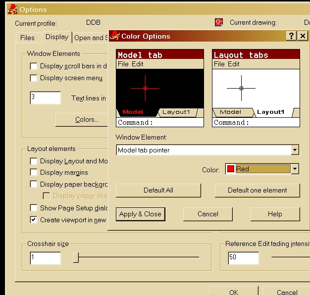

David Bethel Posted January 24, 2010 Posted January 24, 2010 Have you tried setting the crosshair size to 1 and the color to say red? It's a lot easier than a custom routine. Also it might vary from release to release as to builtin options in ACAD. -David Quote
Lee Mac Posted January 24, 2010 Posted January 24, 2010 Here is a toggle for what David suggests: (defun c:test (/ r g b Disp) (vl-load-com) ;; Cross Hair Toggle ~ Lee Mac ~ 24.01.10 (setq r 255 g 0 b 0) (setq *acad (cond (*acad) ((vlax-get-acad-object))) Disp (vla-get-Display (vla-get-Preferences *acad))) (or OldSettings (setq OldSettings (cons (getvar 'CURSORSIZE) (vlax-variant-value (vlax-variant-change-type (vla-get-ModelCrossHairColor Disp) vlax-vbLong))))) (cond (*flag* (setvar 'CURSORSIZE (car OldSettings)) (vla-put-ModelCrossHairColor Disp (cdr OldSettings)) (setq *flag* nil)) ((setq *flag* t) (setvar 'CURSORSIZE 3) (vla-put-ModelCrossHairColor Disp (+ r (* 255 g) (* 65536 b))))) (princ)) Quote
