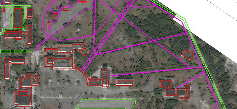

BenGoble Posted January 25, 2010 Share Posted January 25, 2010 Hello, I'm a quite experienced AutoCAD user but I'm wondering if there is a quicker way of drawing vast numbers of trees on a plan rather than inserting hundreds of circular blocks... Here's what I'm working on currently. I've outlined the buildings and path forms and am looking to draw in the existing trees. Is there any way to draw a polygonal form around the tree areas and then convert it via some means into a 2d tree representation i.e. like a fluffy cloud style for the trees? I don't really think there is an easy answer to this but hey, thought I'd ask! Thanks in advance, Ben Quote Link to comment Share on other sites More sharing options...

BenGoble Posted January 25, 2010 Author Share Posted January 25, 2010 Here's what I ended up with... it's a bit rubbish but I couldn't work out where or if there were any standard 'canopy bubble' linetypes available to me in AutoCad. Thus I ended up using the Revcloud option as it was extremely quick. Jalbes and Mather, is there any way you guys could post a small image of what a tree hatch would look like as I can't imagine a hatch showing trees from above? notably I will return to this and make it not look so awful... but I'm pushed for time currently Quote Link to comment Share on other sites More sharing options...
