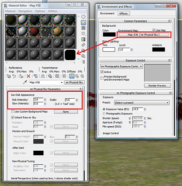

You need to set the sun parameters inside your mr Physical Sky shader.
In order to do this, Follow these steps:
1. Open your "Materials Editor"
2. Go to your "Rendering" pull down menu and select "Environment"
3. In the "Environment and Effects" editor, under "Common Parameters", click and drag the "Map #36 (mr Physical Sky)" over and drop it into an empty material slot in the "Materials Editor". When prompted, make sure you choose Instance. This is very important.
4. In the "Materials Editor", under "mr Physical Sky Parameters", you can adjust the "Sun Disk Appearance" by changing the 3 variables available. Try these settings: Disk Intensity = 2.0, Glow Intensity = 5.0, Scale = 4.0.
You may have to play with the sun position also, to get it low enough so that you can see it in your render.

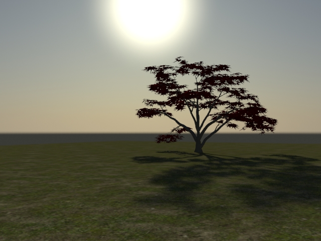

I set up a simple scene, matched your daylight system settings, (changed "Hour" to 16), and hit render. The result is below.
I think maybe you don't have your camera pointed in the right direction?
Edit: Actually, I know you don't have your camera pointed toward the sun because I just took another look at your render and I see the shadows are going away from the camera, which means the sun is behind your camera.
If you can upload your Max file I will take a look at it.
You're right I didn't have the camera pointed towards the sun. I just thought that the sun is visible as long as I could see the icon in my viewport.. Thank you very much for your advice and your patience... :oops:
