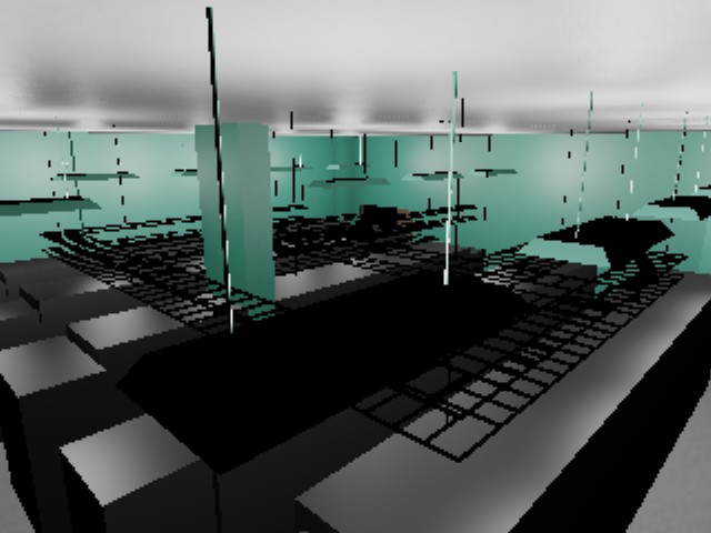

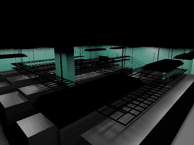

Here are some pics. They are a lower quality rendering, so you can see what I'm talking about. The Draft setting seems to illuminate the entire room, whereas the Low setting (and everything higher) keeps everything above the light level in shadow.
Please forgive the low quality of the drafts and of the work itself. I enjoy working in 3D, but I am poor artistically. In case you're wondering, it's supposed to be a room to house servers, hence the suspended ladder racks.

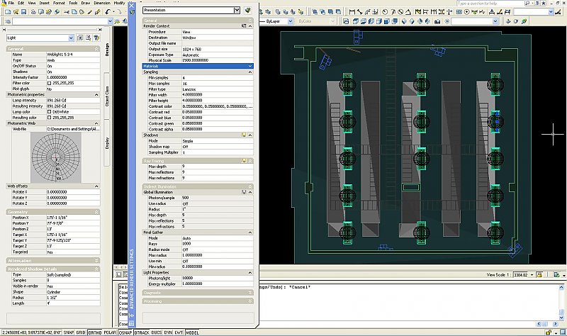

Here's a screenshot that should answer a few questions. Sorry about not answering them before, I'll try to be more thorough in the future.
The lights are point lights with a cylindrical shape; I modified the 4' florescent light that comes with AutoCAD, since I didn't want to create a clear cylinder to go around the light object (other renderings will show from eye-level, so the lights will have to exist). I'm still not pleased with the lights. I spent days on them. I didn't want all that extra rendering time for 28 mostly-clear objects, when I could just have the cylindrical shape already in the light object itself, but at the same time, it was a pain to get a cylindrically shaped point light to cast light in all directions. I'm pretty sure it still doesn't cast the light properly, that is to say, from every point on the cylinder, and in three dimensions. I hacked together a photometric web file from scratch to fix it (a point light casts light in the direction, lengthwise, of the cylinder.. I needed it in all directions), but even that was a shot in the dark. No pun intended.
The roof is 16', the lights are at 13', same with the cowlings. Two 4' lights per cowling, 14 cowlings, so 28 lights total. I didn't mess with the candle power, because I have no idea what the numbers mean, and I figured AutoCAD did. The screenshot shows the room with the roof removed.
I've tinkered with the render settings, but because of my lack of experience, I really don't know what does what. You can ask me how many Rays and Photons I have, I can look at a list and give you a number. I won't really know what it all means.
My screen wasn't large enough to take a screenshot of all the render settings, but I'm pretty sure the menus I minimized are inconsequential to the lighting. If I'm wrong in that assumption, let me know and I'll take another screenshot.
Sorry about the readability of the screenshot.. I'm at work, so I can't access a Photobucket account to get a larger image, and the forum shrinks it fairly dramatically.

Draft uses a simplified lighting model, so the ceiling can look lit with no bounced light. Low and higher presets use ray-traced direct light only, unless you turn on indirect illumination. A cowling around a downward fluorescent correctly blocks direct light from reaching the ceiling, which is why everything above the fixtures goes black.
Turn on Global Illumination and Final Gather in the Render settings. Start with Photons/sample around 500 to 1000 and Final Gather rays around 500, then increase if the ceiling looks blotchy. Give the floor and walls realistic diffuse reflectance (about 0.2 to 0.3 for a floor, 0.5 to 0.7 for walls) so photons can bounce.
Also check that the light source is not fully enclosed by the cowling solid; leave a downward opening, or no light escapes. With photometric units on, intensity in candela or lumens needs to be high enough for a 16 ft room.
