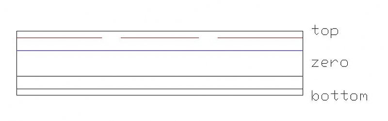

What so hard to understand, how do you know when to use Top justification and Bottom Justification.
i use multi_line also

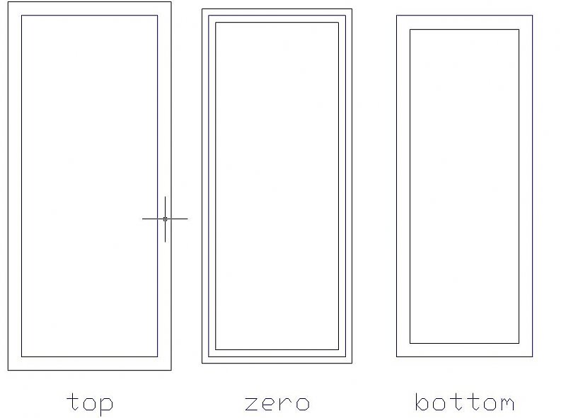

draw a rectangle 3 times
start multiline command (mline, ml)
draw with OSNAP > endpoint around the first rectangle using top justification
draw with OSNAP > endpoint around the first rectangle using zero justification
draw with OSNAP > endpoint around the first rectangle using bottom justification
the first will leave the inner surface of the rectangle as it was
the second will eat half the width of the multiline from the surface of the rectangle
the third will eat the full width of the multiline from the surface of the rectangle
result
if that rectangle was a room with fixed surface dimensions, by drawing a multiline (which in this case may represent a wall) you did ok in the first example (top justification) and in other two cases you did poorly since the room is smaller
other examples are just your way of drawing multilines based on the existing geometry or coordinates you have to draw multiline with.
