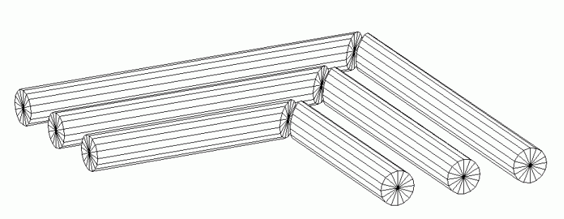

(defun c:mitertub (/ d l r x s i a rl ll vl)
(defun tan (z / cosz)
  (if (zerop (setq cosz (cos z)))
    9.7e307
    (/ (sin z) cosz)))
 (initget 6)
 (setq d (getdist "\nTube Diameter <1>:   "))
 (or d (setq d 1))
 (initget 1)
 (setq l (getangle "\nLeft End Angle -89.9 to +89.9:   "))
 (initget 1)
 (setq r (getangle "\nRight End Angle -89.9 to +89.9:   "))
 (initget 7)
 (setq x (getdist "\nTube Centerline Length:   "))
 (initget 6)
 (setq s (getint "\nNumber Of Tube Segments <16>:   "))
 (or s (setq s 16))
;;;INITIATE ANGLE VARIABLES
 (setq i (/ (* pi 2) s)
       a 0)
;;;RIGHT AND LEFT END LISTS
 (repeat (1+ s)
    (setq rl (cons (trans (list (* (cos a) d 0.5)
                                (* (sin a) d 0.5)
                                (* d 0.5 (sin a) (tan r)))
                           0 '(1 0 0)) rl)
          ll (cons (trans (list (* (cos a) d 0.5)
                                (* (sin a) d 0.5)
                                (* d 0.5 (sin a) (tan l)))
                           0 '(1 0 0)) ll)
           a (+ a i)))
;;;CREATE THE MESH LIST
 (setq vl (list (list 0 0 0)
                (last ll)
                (list (car (last rl))
                      (- (+ (cadr (last rl)) x))
                      (caddr (last rl)))
                (list 0 (- x) 0)))
 (while ll
    (setq vl (cons (list 0 0 0) vl)
          vl (cons (car ll)     vl)
          vl (cons (list (car (car rl))
                         (- (+ (cadr (car rl)) x))
                         (caddr (car rl))) vl)
          vl (cons (list 0 (- x) 0) vl)
          ll (cdr ll)
          rl (cdr rl)))
;;;MAKE THE MESH
(entmake (list (cons 0 "POLYLINE")
               (cons 10 (list 0 0 0))
               (cons 66 1)(cons 8 "3D")
               (cons 70 16)
               (cons 71 (1+ s))
               (cons 72 4)))
(foreach v vl
   (entmake (list (cons 0 "VERTEX")(cons 8 "3D")
                  (cons 10 v)
                  (cons 70 64))))
(entmake (list (cons 0 "SEQEND")(cons 8 "3D")))
(prin1))

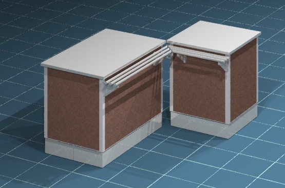

For mitered ends of tubular tray rails. -David
