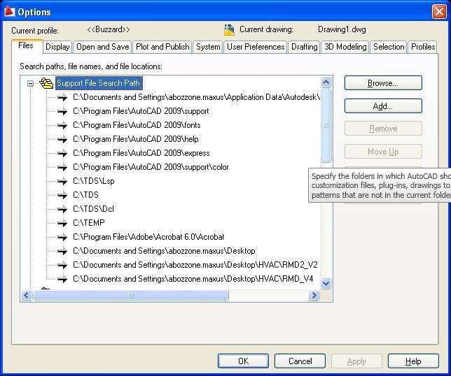

Hi Buzzard.
I can download the RMD.I add to Autocad.I write to autocad RMD.But ı can't run RMD.How run is the RMD.What write behove to autocad for run RMD.Please you facilitate to me.Thank you for program.
Zafer
Hi Buzzard.
Zafer
Hi Zafer,
Be sure you keep the DCL & LSP files together, Make sure they are in the ACAD Support Search Path. This you set in your Options under the File tab.
There are several ways to load a lisp file. See the link below:
http://www.cadtutor.net/forum/showthread.php?t=1390
Once the lisp has been loaded, You type RMD at the command prompt.
Hope this helps.
Let me know if you are still having problems.
