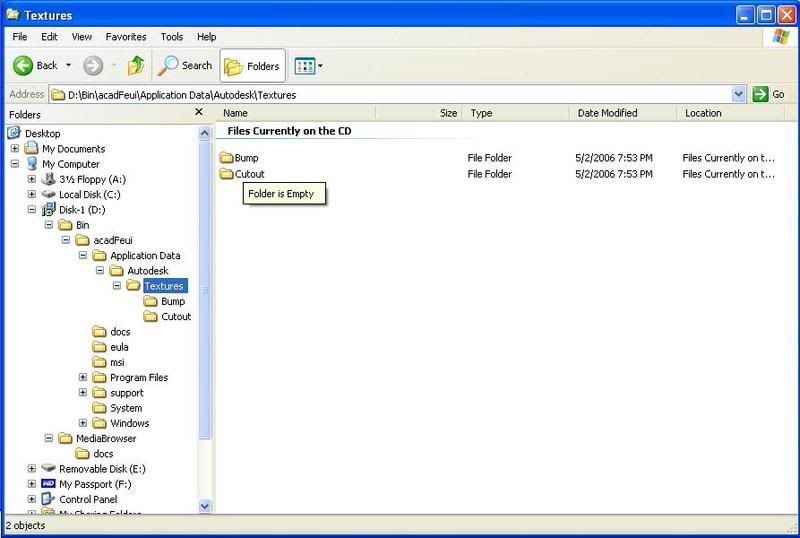

kellenhaskell Posted August 15, 2008 Author Share Posted August 15, 2008 and when i explore the disk i have for autocad 2007 i see this. Obviously no textures and the other folders are empty.. So from here is there somewhere i can go to to add textures to my autocad library? I only would need some wood grains and maybe some glass. THANK YOU Quote Link to comment Share on other sites More sharing options...
Cad64 Posted August 15, 2008 Share Posted August 15, 2008 As Secretagdan said, the materials are on the installation disk. Just get the disk from your boss and install them. You can also make your own textures or get images from the web. Take a look at THIS thread for sites that offer free materials. Quote Link to comment Share on other sites More sharing options...

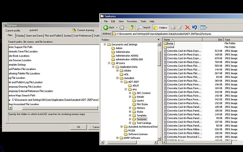

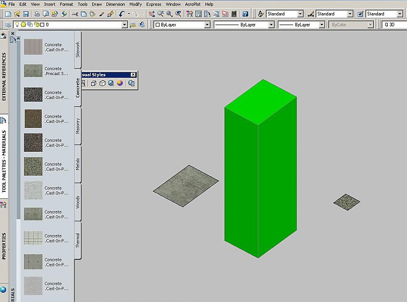

qball Posted May 28, 2009 Share Posted May 28, 2009 yep, materials. "Looking for your additional Material Library content? If you don’t see a Material Library tool palette group, right-click on the Tool Palettes titlebar and go to Customize Palettes. Drag all the palettes ending in “ – Material Library” on the left side (Palettes) into the Material Library palette group on the right side. Close the Customize dialog, and your Material Library palette group will now be fully populated with additional content." This didn't work because under my Customize Tool palettes none ended in "- material library". So as mentioned I created the palettes by dragging the .jpg images to a palette, but I don't think they are materials. I can't drag from the palette to a solid or surface on my drawing. It seems to just insert a 2d raster image. here's a screenshot showing my created palettes, Customize menu, and RMAT tab in the background. The image on the right is solids and surfaces that I created a while ago, but deleted the images that I used from the internet before I found the acad materials library. It's a long annoying process to get the materials on that image using RMAt and browsing and picking each .jpg to attach from C: drive. I should just click and drag to the solid. And then edit in RMAT. Right? Quote Link to comment Share on other sites More sharing options...
Cad64 Posted May 28, 2009 Share Posted May 28, 2009 In "Options" check your texture maps search path. You may need to repath your materials. Otherwise, you may need to insert your installation disk and run a repair. I've deleted your other post. Please only post your question once. And in the future, please start a new thread when you have a question. :wink: Quote Link to comment Share on other sites More sharing options...

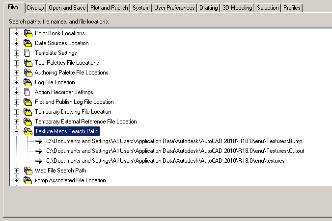

qball Posted May 28, 2009 Share Posted May 28, 2009 Cad64, sorry about the other post... seems I get over one wall and then just hit another. Seems like a double posting, I know they're annoying. My Texture Map Search Path matches the .jpg material locations. I just can't click and drag from the palette to the object on the screen. Which makes me think my custom Material Palette isn't set up right. And there was no default Material Palette. 1st image shows that search path is right. 2nd image shows that I try to drag from palette to the green solid, and the materials just end up a flat 2d raster. All the instructions on line just say "click and drag"??? edit: just realized I'm repeating myself a lot and I sound like a ********. But it's pretty frustrating. It seems so (potentially) simple. haha ^^^^ automatic sensoring! too funny! Quote Link to comment Share on other sites More sharing options...
