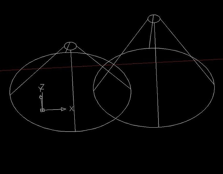

StevenMc Posted February 16, 2010 Share Posted February 16, 2010 Hi, Does anyone know if AutoCAD 2009 can work out the volume of the overlapping part between two cones? i have attached a screenshot to clarify. Both of the cones are on the same x,y plane. Or... if anyone could help with maybe a better way to do this. currently i have drawn two cones beside each other and made them overlap slightly and was just wondering if it was possible for autocad to work out the volume of the overlap. regards, Steven Quote Link to comment Share on other sites More sharing options...

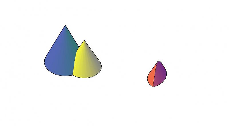

ReMark Posted February 16, 2010 Share Posted February 16, 2010 Before and after. Two cones (blue & yellow) before using the Intersect command. Resultant geometry (red) after using the command. This is their shared volume. Quote Link to comment Share on other sites More sharing options...
ReMark Posted February 16, 2010 Share Posted February 16, 2010 Result of MassProp command on the shared geometry (red) shown above. ---------------- SOLIDS ---------------- Mass: 59.5341 Volume: 59.5341 Bounding box: X: 27.4036 -- 32.3243 Y: 55.0968 -- 63.6438 Z: -0.0004 -- 5.3038 Centroid: X: 29.9502 Y: 59.4189 Z: 1.4586 Moments of inertia: X: 210548.3838 Y: 53652.0232 Z: 263801.4506 Products of inertia: XY: 105961.8089 YZ: 5159.3817 ZX: 2602.4070 Radii of gyration: X: 59.4694 Y: 30.0200 Z: 66.5665 Principal moments and X-Y-Z directions about centroid: Press ENTER to continue: I: 232.7719 along [0.9888 -0.1325 -0.0681] J: 120.6437 along [0.1328 0.9911 0.0000] K: 207.5334 along [0.0675 -0.0090 0.9977] Write analysis to a file? [Yes/No] : n Quote Link to comment Share on other sites More sharing options...

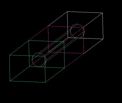

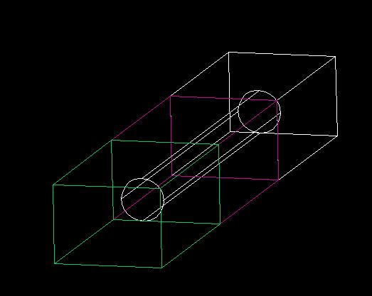

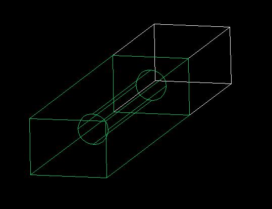

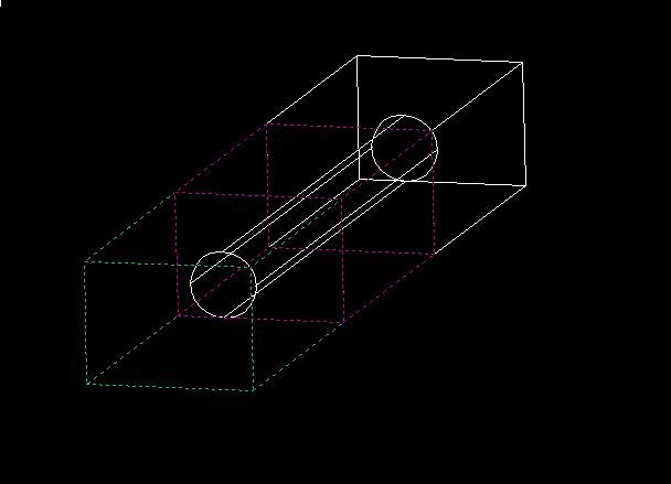

Crazy J Posted February 16, 2010 Share Posted February 16, 2010 INTERFERE is an other usefull command. It can build the intersection without loosing the given cones. Beat me to it... INTERFERE allows you to do some creative things when dealing with some complex 3D solids. One example, if I have a series of parts and want to put a through hole through all of them of the same diameter (or even just the same center and I can offset the diameters later), then INTERFERE is what I use. I draw a cylinder on center long enough to go through all components that will be affected. Then create an interference set. Delete the original cylinder, and you will have X individual smaller solids that can then be subtracted from each component. This is useful b/c if you use subtract and chose multiple objects for you "subtract from" set, they become merged into a single object when the command is completed. This is what I show in the four pictures below. If you have objects on multiple layers, they will all end up the layer of the first object selected. Not a very good part of the SUBTRACT command IMO. Quote Link to comment Share on other sites More sharing options...
