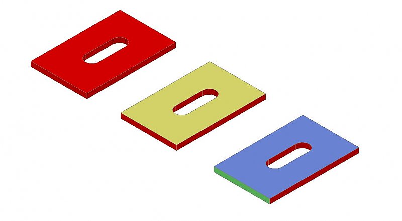

If you find that an object is too long (or too short) like an axle for example the Move Faces command can be used to correct the length. Since it is a 3D solid the Stretch command won't work.

Your want to go to your Solids Editting toolbar and find the one for Color Faces. AutoCAD will prompt you to Select faces or [undo/Remove]. Select the top edge of the side of the skateboard you're working on. If all goes well AutoCAD will dash just the top face but it may detect/select more than one face and that is where the Remove option comes in handy. So let's say two faces were selected and we want to remove one. Type R for Remove press Enter and go remove the face you don't want. When done hit Enter again. A Select Color window will appear onscreen. Select the color you wish to use on the face. The color is applied to the face. Look good? Fine. Type X to eXit the command. If you did this in 2Dwireframe (as I do) switch to a conceptual visual style to see and review the results. How do the results look to you? Did the face get colored and the remainder of the board stay as it was originally?
Here is an example.
The original object in red is on the left. The middle object has color applied to the top face. The left hand object has color applied to the top face and one edge (facing us). Clear now?
