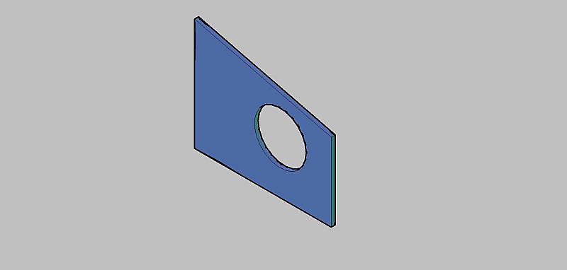

ReMark Posted February 20, 2010 Posted February 20, 2010 Sometimes I think we just make things harder on ourselves then they have to be. I punched an opening through your wall with no problem. Locating it was easy. Why are you using 3Dfaces? I think it just complicates things. Quote

ReMark Posted February 20, 2010 Posted February 20, 2010 AKRider...5 posts. I'm going to give you the benefit of the doubt and say it was just your frustration coming through in your remarks. Sound fair? How did I do it? For starters I used solids just like many other forum members would have. As I said locating the window was easy. I just reoriented my UCS, drew a circle using the 36" radius and moved it into the correct position. I then extruded the window. Next, I used the polyline command to trace out the perimeter of the wall and extruded that as well. Finally, I subtratced the circle from the wall to obtain the opening. Does that explanation answer your questions? Quote

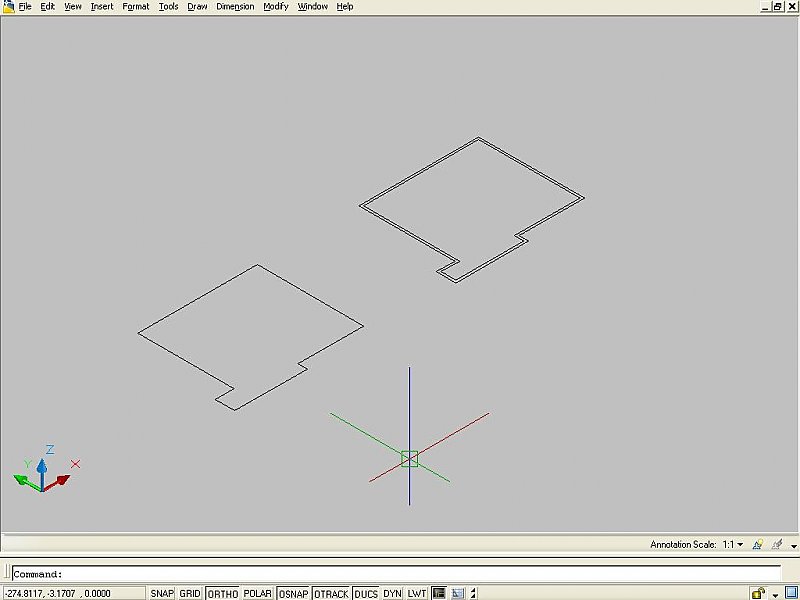

a1harps Posted February 21, 2010 Posted February 21, 2010 Ok...this is kind of fun and i am learning a few new things along the way! Likewise I am not saying this is the only way or the fastest or the best way...just a way. In fact I hope the more experienced will weigh in. Below I have drawn the exterior wall plan with a zero thickness polyline and then offset it inside by the wall thickness. I wanted to use polylines with preset wall thickness to avoid extra work but I don't know how to do it without a bunch of adding and subtracting wall and half wall thickness in order to draw the actuall wall lengths from the original drawings. In the second screen shot I extruded both polylines to the height of the tallest side of the "rake". Quote
