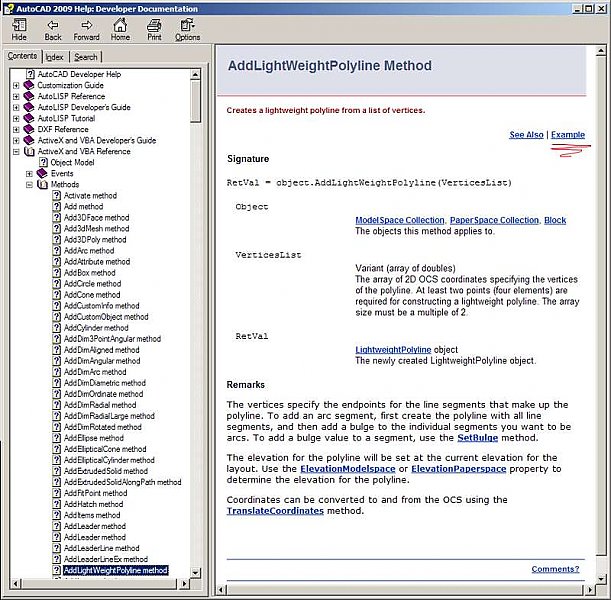

It sounds like you need a LightWeight Polyline. If that is the case then look in the VBA help reference for the AddLightWeightPolyline method. I modified the example given in that reference to produce a 10 x 10 square.
Sub Example_AddLightWeightPolyline()
   ' This example creates a lightweight polyline in model space.
   Dim plineObj As AcadLWPolyline
   Dim points(0 To 9) As Double
   ' Define the 2D polyline points
   points(0) = 0: points(1) = 0
   points(2) = 10: points(3) = 0
   points(4) = 10: points(5) = 10
   points(6) = 0: points(7) = 10
   points( = 0: points(9) = 0
   ' Create a lightweight Polyline object in model space
   Set plineObj = ThisDrawing.ModelSpace.AddLightWeightPolyline(points)
   plineObj.Closed = True
   ZoomAll
End Sub
