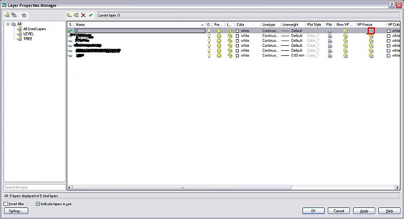

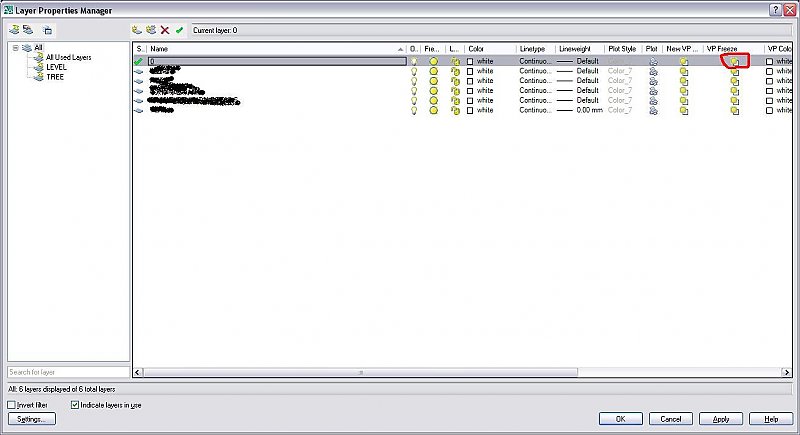

skipsophrenic Posted February 22, 2010 Posted February 22, 2010 If you know what layers the objects are on you could freeze then. (see attatched images) Unfrozen Frozen Quote
Ghazi Toutounji Posted February 22, 2010 Author Posted February 22, 2010 That would probably be the way and that's what I am doing, but the difficulty is that I have to check in the xref to see which layers I should freeze, etc. Thanks. Quote
