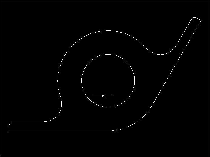

bbankston Posted February 24, 2010 Posted February 24, 2010 I was coming on to help but I see you've got everything covered, ReMark. TYGA, You're missing the dimensions of the radii at the ends of both legs and you don't have a width/height for those legs. It's pretty straightforward to draw. Of course you could always find out what the missing dimensions are by printing the drawing out and measure it. Quote
bbankston Posted February 24, 2010 Posted February 24, 2010 TYGA, That took me a minute. I guessed at the widths/heights of the legs and their radius-ed corners but visually it looks pretty much spot-on. The only trouble I ran across was the location of the center circle but then I realized that it's at the same position as the 110 dia. circle (it fillets your outer lines). Quote

TYGA Posted March 3, 2010 Author Posted March 3, 2010 well i guess this is the answer right guy's , used the fillet command in most of it. but at last here it is MY Draw.dwg Quote

bbankston Posted March 3, 2010 Posted March 3, 2010 You're drawing is incorrect, TYGA. Take a look at the outer dimensions for your drawing and the drawing you provided on page 1 of this thread. Quote
TYGA Posted March 4, 2010 Author Posted March 4, 2010 You're drawing is incorrect, TYGA. Take a look at the outer dimensions for your drawing and the drawing you provided on page 1 of this thread. well bbankston , i divided all of the dimensions by 10 to reduce the space of the drawing , 100 and something is very big ......... right ? , any way thanks for help man , you rock . Quote

Glen Smith Posted March 4, 2010 Posted March 4, 2010 If you are satisfied with your drawing then so be it. I've never seen a "solved" check box for a thread. But the drawing that you posted has at least one error in it that bbankston pointed out. You have the 140 now 14 dimension going from the end of the radius to the corner. The original drawing shows that dimension from the intersection of the (2) 140 unit lines. As for changing the scale, this is not a good habit to get into. Always draw at 1:1 in model space. AutoCAD does not care, and the file size is the same whether it is in millimeters or light years. Scale is taken care of when you move to paperspace. Glen Quote

JD Mather Posted March 4, 2010 Posted March 4, 2010 .. i divided all of the dimensions by 10 to reduce the space of the drawing , 100 and something is very big ......... right ? Ask more questions about this - what you did is considered to be about the worst offence (maybe second to explode) in CAD and completely unnecessary. Quote
ReMark Posted March 5, 2010 Posted March 5, 2010 TYGA: Looks like you did not follow the number one rule: draw FULL size in model space. Go sit in the corner and contemplate your transgression. Then get up and write the following 100 times: I will not divide all dimensions by 10 to reduce the space (size) of the drawing. Quote
