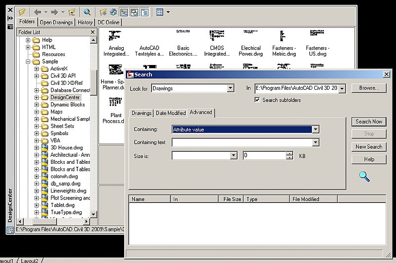

Just so you know, you can perform this search with Design Center.
That's where my inexperience in AutoCAD shows... o:)
Spend a little time with it. Autodesk thought of a few good things.

Nothing against Lee, but you don't need it. Design Center has the option.
I'm trying this now and it seems to be doing just what I want. I tried the DataExtraction tool (which puts the data in a spreadsheet) but it just bogged down and hung. Didn't know DesignCenter did this!
To Lee, I am still grateful for your help, as I am trying to learn to LISP and I need all the good examples I can get!
