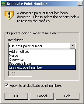

Ah here you go friend. From the help file:
Resolution Specifies how the point number conflict is resolved:
  • Add An Offset: Adds the offset specified for the Add An Offset From option to the source point number. For example, if you enter an offset of 200, source points with numbers 1, 2, and 3 are re-numbered 201, 202, and 203.
  • Merge: Overwrites point data that exists in the destination point with data that exists in the source point and preserves data in the destination point that is not supplied by the source point.
  • Overwrite: Overwrites the destination point.
  • Sequence From: Begins renumbering the source points using the point number specified in the Sequence From option.
  • Use Next Point Number: Assigns the next unused point number to the point.
Add An Offset From Specifies the offset to be added to the source point number when the Resolution is set to Add An Offset. Enter an integer.
Sequence From Specifies the starting sequence number for renumbering the source points when the Resolution is set to Sequence From. Enter an integer.
Apply To All Duplicate Point Numbers Specifies that the Resolution setting is applied to any additional duplicate point numbers encountered by the command. If a duplicate point number occurs that cannot be resolved based on the Resolution setting, this dialog box displays again.
And here is the duplicate point number dialogue (see attached) you should see when you go to import the duplicate points.
yes, I looked at this yesterday and this is for the point number/name I believe not the actual coordinates themselves. I have points that have the same coordinates but have different information attached to them and civil3d makes the points as one graphical point with two arrows pointing from each set of information. The problem is when I sort them only set of data will show up in a sort. So if the date on one is 11/2/07 and the date on the other is 11/3/07 and the coordinates are the same, when I sort this by 11/2/07 the point will show up in the sorted data, but when i sort it by 11/3/07 the point is simply not there. I need civil3d to make an object/block for every point coordinate even the ones that have duplicate coordinates. It is imperative that I am able to sort them and see all the points that should be there.
