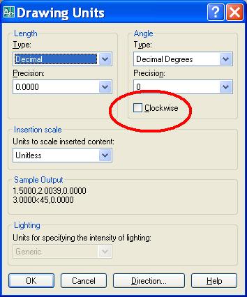

lpseifert Posted March 13, 2010 Share Posted March 13, 2010 Do you see that Direction button in the image above? I'm guessing that LT has Help Quote Link to comment Share on other sites More sharing options...
yawningcaptain Posted March 13, 2010 Author Share Posted March 13, 2010 Oh I see... I only stick with the variable thing... Not knowing y, I just dun like setting things in the dialog boxes... Quote Link to comment Share on other sites More sharing options...

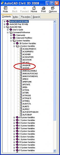

eldon Posted March 13, 2010 Share Posted March 13, 2010 System variable ANGBASE should be 0 for normal AutoCAD drawing. It sounds as if a surveyor has been at your drawing and set up the Angles to suit a surveyor. Quote Link to comment Share on other sites More sharing options...
