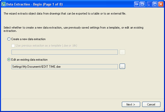

Data Extraction...
Select my DXE file...

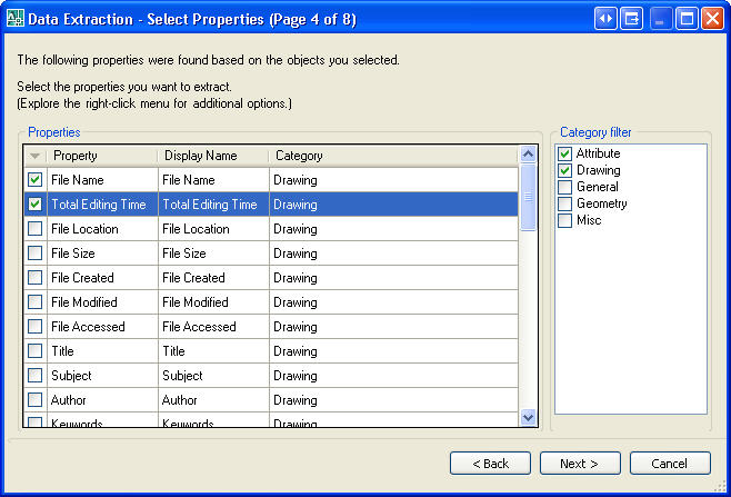

Total Editing Time under the category Drawing...
Some number...

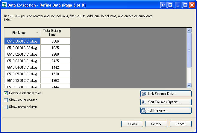

It looks like that is simply extracting from the drawing properties that you would see if you examined the file properties by right clicking in Windows Explorer.
My guess is the value is in either minutes or seconds - you could test it by begining a new file and keeping it open for several minutes, close it and check against the value you extract.
If you are looking to find the actual editing time you may be disappointed in finding the value simply reflects the time you have the drawing open and activating/deactivating the time mechanism within AutoCAD. At least I think that's how it works.
Doing so gives me minutes. :thumbsup: Thanks.

Using Data Extraction, I get a value of "201". What does this value represent?
Just so it's clear for those who know how to use the search, the extraction represents minutes.
