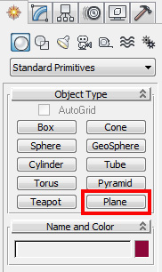

grain Posted March 20, 2010 Author Posted March 20, 2010 Thanks again. Another smaller problem Ive used boxes for the billboards. Should I have used planes as Im picking up some marks around the edges. Is there any simple way of changing them to planes. Quote

Cad64 Posted March 21, 2010 Posted March 21, 2010 'Make Planar' will collapse your box and make it flat, but you will see a big problem once you do this because the front face and the back face will now share the same space, thus overlapping and causing display problems. If you want to create a plane, just select Plane from the "Create" panel. Quote
