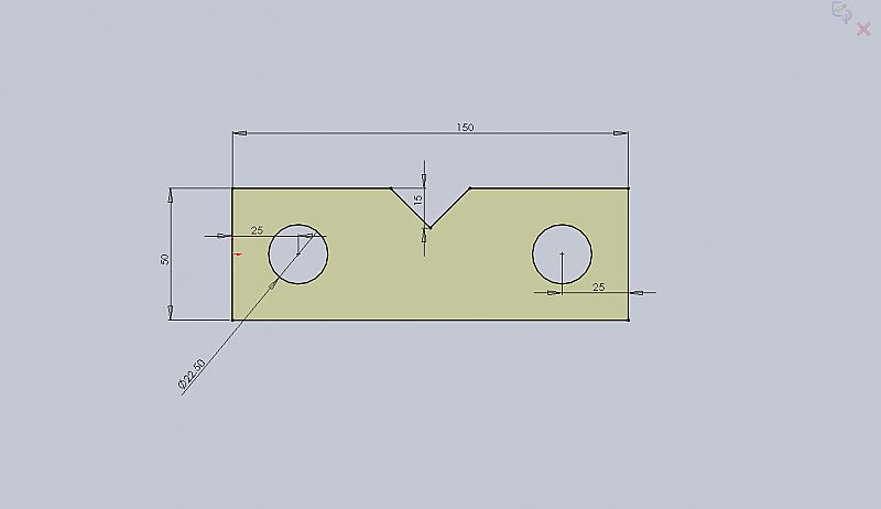

First the sketch for the main block. You can see the origin is at the midpoint of the left edge. This also puts both holes center points horizontal with this. I could have done a little more with symmetry for the twho holes but i just added a dimension.

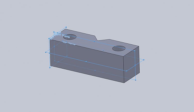

In the second pic you can see all 3 standard work planes are centered on my block. The extrusion i did as a Mid Plane rather than blind to keep my front and top plane centered. This made it easy to extrude the handle as the origin was the locator for my circle.

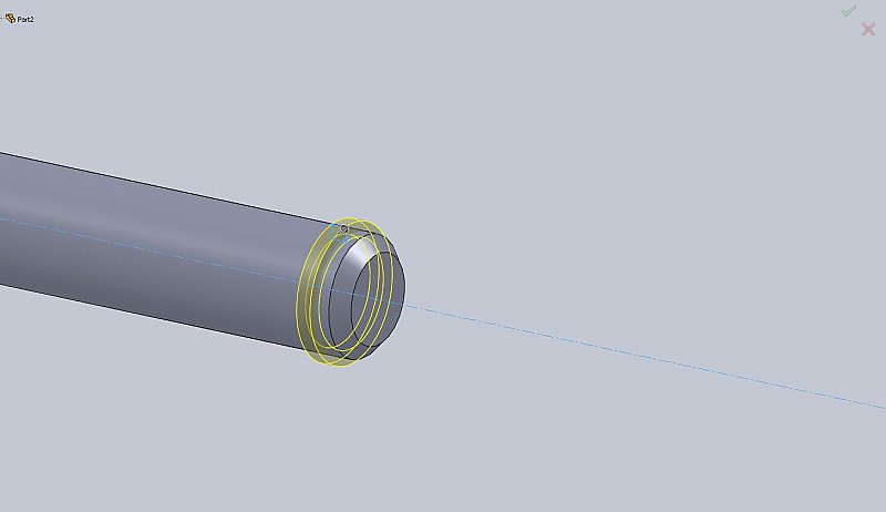

For the groove you can see my sketch. The dashed line is a horizontal(infinate length) reference line from the origin. This will be used as my revolve axis.
Image 5 shows a preview of the revolve/cut
Image 6 just shows a close up view of the cut(G for Magnifying glass).

Hey paul, take a look at the first image i uploaded. the origin(red) is at the mid point of my initial rectangle. If you select your vertical line and the origin point you can choose midpoint as one of the relations.
I would strongly recommend taking this approach to modeling as it will simplify everything from updates, plane creation and being able to use symmetry about the origin. However with your model you can still follow the same procedure by creating a work plane that is centered.
