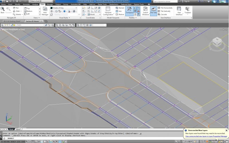

PEGAdevelopment
The key is feature lines. You need to use feature lines to transition from one corridor to the next. You will have to stop the first corridor then have a transition area that is solely feature lines. This will connect to the second corridor which has a different assembly.
You need to draw 3d polylines in the transition area by hand, then convert them to feature lines, then add them to the surface as breaklines.
Here is an example pic where I had a boulevard section with medians, but needed to transition to an area without medians. The orange lines are feature lines that have been added to the surface as breaklines.
