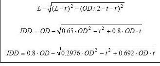

Hello to all,
Attached below are three formulas to solve for distance for ellipsodial heads of different types.
My question is can each formula be written in one argument or does it need to be written in several?
I am not completely sure how to break this down. Any help on this would be greatly appreciated.
Again Thank You in advance,
The Buzzard

Sorry,
I think I explained myself incorrectly.
What I meant was can each formula be written in one statement with the given arguments.

alanjt
I probably overlooked something, but this should be a good example (your first function)...
(defun foo (L r O D tt / _sq)
 (setq _sq (lambda (#) (* # #)))
 (- L (sqrt (- (_sq (- L r)) (_sq (/ (* O D) (apply '- (list 2 tt r)))))))
) ;_ defun

The Buzzard
Sorry again,
Fixo,
I do not mean to combine all three or a way to pick a formula.
For each formula above can the supplied arguments be put into one continuous statement for each formula.

alanjt
Thanks Alan,
I think I can figure the rest from here.
But what is apply in the statement for.
It was to subtract the 3 numbers, but I completely forgot you can add more than 2 numbers to the (- function.
 (- L (sqrt (- (_sq (- L r)) (_sq (/ (* O D) (- 2 tt r))))))
) ;_ defun

Lee Mac
Nice one Alan :thumbsup:
This is the only improvement I can see:
(defun foo (L r O D tt / _sq n)
 (cond (  (minusp (setq n (- (_sq (- L r)) (_sq (/ (* O D) (- 2 tt r)))))) nil)
       (  (- L (sqrt n)))))

Lee Mac
Now you tripped me up Lee,
Whats with the condition?
Square roots of negative numbers don't exist in the Reals :)

The Buzzard
But in that case, could'nt you just use abs in there someplace.

Lee Mac
But then you are changing the formula... :wink:

alanjt
One minor change to #2:
 (cond (  (minusp (setq n (- (_sq (- L r)) (_sq (/ (* O D) (- 2. tt r)))))) nil)
       (  (- L (sqrt n)))))

Lee Mac
Excellent spot - that would have you looking for days for that bug... :cry:
