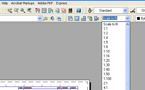

sparkyuk Posted March 29, 2010 Posted March 29, 2010 I have a A1 template or what ever size paper I require and all I do is to doulble click inside of my viewport, then select what i want to have in my view port, then in the pull down in my viewports tab *(see attached picture)select what ever scale i want and bobs your uncle its done, I dont know if this is the correct way but works for me Quote

sparkyuk Posted March 29, 2010 Posted March 29, 2010 gsksun4 If you have not got viewports tab showing,right click at the top where the viewports are showing, as on my picture i posted above then a drop down menu will come down select viewports and it will appear at the top as it is on my picture Quote

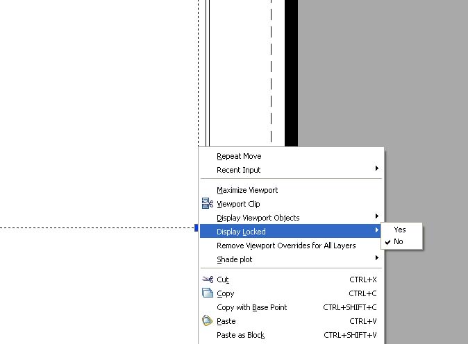

bonehead411 Posted March 29, 2010 Posted March 29, 2010 Thank you, I added the toolbar as you suggested, however in 2009LT the scale dropdown is grayed out and is nonfunctioning. Did you have a locked viewport selected at the time? Quote
ReMark Posted March 29, 2010 Posted March 29, 2010 How unlucky are you? You don't have a 32" LCD monitor? Quote
gsksun4 Posted March 29, 2010 Posted March 29, 2010 Did you have a locked viewport selected at the time? Thanks, not sure how to check that, I'll have to do it in the morning. Only have cad at work. I'll be sure to look into it. Quote
ReMark Posted March 29, 2010 Posted March 29, 2010 Highlight the viewport and right-click. Look at the entry for Display Locked. It is either No or Yes. Quote
gsksun4 Posted March 30, 2010 Posted March 30, 2010 Highlight the viewport and right-click. Look at the entry for Display Locked. It is either No or Yes. By highlight, you mean double click? That puts the model/paper space button to model and thickens the layout frame box. I then right click and it says already in model space at the command line. I'm not so sure I have a viewport now. I do have the area of the dwg isolated to the space in the layout frame, and can plot what I want OK. I have two tabs named Page 1 and Page 2. I did get the viewport toolbar activated and the scale thing can now work though. Think I'm lost with the viewport thing. I hardly use them, so I guess I need a class or something. I thought I had it, but I guess not. Thanks for your effort all. Quote
bonehead411 Posted March 30, 2010 Posted March 30, 2010 No. don't double click within the viewport, just click the viewport boundary once, then right click and somewhere near the top of the list it should say Display Locked.... Make sure your viewport layer is turned on before you try this, otherwise you may just be clicking your drawing border. And stick with it, once you get it, you'll wonder how you got by without them. Quote
SPARKY77 Posted March 30, 2010 Posted March 30, 2010 When you click on the viewport there should be a lock symbol on the bottom of the screen, if it is grey the viewport is locked, if it is yellow it is open. Quote
gsksun4 Posted March 30, 2010 Posted March 30, 2010 No. don't double click within the viewport, just click the viewport boundary once, then right click and somewhere near the top of the list it should say Display Locked....Make sure your viewport layer is turned on before you try this, otherwise you may just be clicking your drawing border. And stick with it, once you get it, you'll wonder how you got by without them. OK, I just clicked once on the layout frame. The green solid line box around the drawing. The line went dashed with grips at the corners. I assume that's highlighting the viewport. No list comes up. I right click once in the viewport and the layer manager come up. Now I'm thinking I should do something with the "New Layer Frozen In All Viewports" button at the top of the manager. All my layers are on, but I see no viewport layer. Sorry to be so uneducated in this area. It's one of those things in cad I never had to address. Quote
ReMark Posted March 30, 2010 Posted March 30, 2010 Do NOT click INSIDE the frame of the viewport once it is highlighted. Place your cursor outside the frame and right-click. Display Locked will be the sixth entry from the top of the list that appears. Quote
