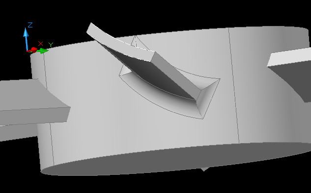

I'm using 2011 version to try and crate a propellor. The lade is a dxf import. I created a hub to it and made a circular affay of the blade.
What I am looking for now is a way to ceate a fillet between the "airofoil" blade and the conical hub.

It's quite possible... Try combining the blades and the hub with union then fillet each edge. Chain option may or may not work depending on how complex the foil is.

I accidently selected some lines, wich were not needed, it did become one part. The baldes actully are a surface! I can not change them to a solid.
Fillet returned this:

Unable to fix face orientations.
Modeling Operation Error:
Coedges are not configures as expected.
Unknown convexity.
Failed to perform blend.
Failure while filleting.
The blades were made from a mesh, which was hard to transfer to a surface.

I stitched the mesh surfaces to a solid in Inventor - but the zipped file was a little over the limit.
In any case I would not use a mesh to model this (even in AutoCAD) as the results is not a curved face but rather a bunch of planar faceted faces representing a curve.
You could Loft this as a solid in AutoCAD and the results would be much better.

I tried the part you sent me, but still the fillet fails. It gives a preview of the fillet, but is says teh fillet failed.

I think if you give the preview a good look you will see why it fails. Doesn't matter what program you use - you will need to get a good NURBS face rather than these faceted planar faces.
You could use the existing geometry to set up a Loft.

I just tried to loft the ribs which I traced using PlineCV. But still I still can't create a fillet. Any ideas what I could try?

If you do a List do you have surfaces or do you have solids?
I'll answer the question for you - you have surfaces.
Also, I would not use a "knife-sharp" edge along that trailing edge.
If you look at real parts it would not be razor sharp but have a bit of a rounded edge. This will help your fillet go around the edge.
I did allready sculpt them to a sold, probably is the sharp edge which is bugging me. Somehow I do not get this edge filleted.

About the fillet, when I trace the cross-sections with Spline CV, and use the close command it does not make asharp edge.
I was able to make a small fillet with a max. radius of 3mm. I don't know why this fillet does not want to be made with a 5mm radius. The preview does not quite match the foil-shape.
