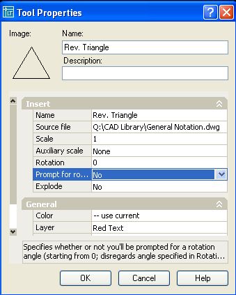

If you drop blocks in from a tool palette you can set to prompt for rotation within the tool properties.
