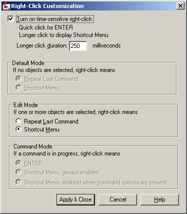

Have it set so you right-click will act as Enter, but if you hold down right-click for XX ms, it will display the right-click menu - best of both worlds.
thanks folks.. I appreciate the tips!
