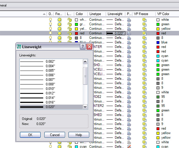

For anyone else viewing this thread:
To disable the display of lineweights on screen, click the LWT button along the bottom of your screen. Or go to your "Format" menu and select "Lineweight". In the "Lineweight Settings" dialog, uncheck "Display Lineweight".
To change the lineweight display of entities per layer, open your Layer Manager. In the "Lineweight" column of the layer you want to affect, you can change the lineweight of the layer by clicking on it. This will open a Lineweight dialog and you can choose the weight that you would like.
