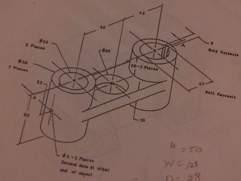

kuwait Posted April 14, 2010 Posted April 14, 2010 helloooooooooooooooo:) from the first time i did this completely by myself please check it did i miss something??? enriqe.dwg Quote
ReMark Posted April 14, 2010 Posted April 14, 2010 Well I like that you use different layers and colors for different features. You have a layer called ph - phantom line type - color: blue yet you use it as one would a centerline in your plan view. Why is that? The dimension shown as 128 in the front view lists the linetype "center" when I check it's properties yet in the Layer Properties Manager you have assigned the continuous linetype. Why did you override it? Now that I've checked all your dimensions I see that for some reason the linetype is listed as "center" and not as "continuous" per the layer settings. Don't do that. Layer 0 is black. Your section line A-A text is blue yet it is on layer 0. Why? I would recommend creating a separate layer called Text. Zooming in close on some of your geometry I noticed some irregularities. Ex. - dimension extension lines that don't quite match up with the object (looks like they shifted a bit). A couple of other oddities too. Might want to go back and check. Do you use Osnaps on a regular basis? Quote

dbroada Posted April 15, 2010 Posted April 15, 2010 Your section AA is incorrect. you have correctly shown the middle hole but you have not shown the other two vertical holes or the 5mm hole. you have dimensioned the boss twice but not the hole. the hidden lines in the end view do not pick up the large vetical holes Quote
stevsmith Posted April 15, 2010 Posted April 15, 2010 In addition to Dave's comments I would also comment on the centreline projection of the centre hole that do not tie up with your projected view. Quote
ReMark Posted April 15, 2010 Posted April 15, 2010 Seems like someone needs to go back to the drawing board. Quote
kencaz Posted April 15, 2010 Posted April 15, 2010 Your section AA is incorrect. you have correctly shown the middle hole but you have not shown the other two vertical holes or the 5mm hole. you have dimensioned the boss twice but not the hole. the hidden lines in the end view do not pick up the large vetical holes Another good reason to model in 3D. You don't have to worry about how your section is suppose to look, it's created for you. KC Quote

JD Mather Posted April 15, 2010 Posted April 15, 2010 I ran out of time and I am missing a couple of center lines - maybe something else as well, but this should give you some ideas. Kuwait.dwf Quote
MikeScott Posted April 15, 2010 Posted April 15, 2010 Nice.. I like the way the part is curved in the section JD did.. Within the cutout of the 5mm hole on the exterior profile. That line would indeed curve away like that.. it's a nice touch. The 5mm holes gave me pause until I realized JD drew them wider than the supposedly 5mm internal slot, so JD's section is showing where that hole cuts the sides of the track. It shouldn't do that if the hole is the same width as the track. I was unable to see Wilbri's.. since I'm using an older version of CAD. Quote
JD Mather Posted April 15, 2010 Posted April 15, 2010 ...It shouldn't do that if the hole is the same width as the track. I was in a hurry and didn't catch that - I drew for a square key rather than a rectangular key. Quote

JD Mather Posted April 15, 2010 Posted April 15, 2010 ... unable to see '... since I'm using an older version of CAD." Here is a redline of the original. If the OP posts a revised drawing I will revise my solution as well. enriqe.dwf Quote

MikeScott Posted April 16, 2010 Posted April 16, 2010 Here is a redline of the original. If the OP posts a revised drawing I will revise my solution as well. Thanks, JD. I downloaded True view, and it permitted me to open his original, but I can't open your DWF with CAD or TrueView (TV only accepts DWG or DXF). All I can say is that they really need to look at using Object Snaps for just about EVERYTHING they draw... there's a lot of things in that drawing that wouldn't be out of alignment if they'd done that. Also, they need a better understanding of how a section works.. Draw a guideline down from anything that intersects the section line, or would be visible beyond it... those are your guides to where things It seemed as though the bottom view was a cross between a section and a sideview, but some portions didn't align with either type of view. For example, where that middle table portion runs into the two main keyways. From a SECTION VIEW, in the position they had the section marker, that table should have visually stopped as soon as the cylinders started (rather than the overlap that was drawn). In a SIDE VIEW, the table would appear to continue all the way to the centerlines of the cylinders. That's because in the top view, you can see that that's how far it goes before there's a change in direction. Quote
