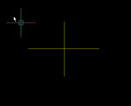

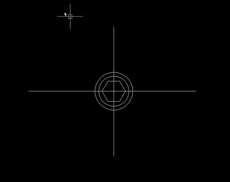

Numerics Posted April 20, 2010 Author Posted April 20, 2010 You are creating geometry form 2 separate disciplines. I would make it 2 separate drawings. ok, so for the double door swing, there is 3 lays, right? Quote
TimSpangler Posted April 20, 2010 Posted April 20, 2010 For the door I see 2 layers for the rocker I see 3 layers Quote
ReMark Posted April 20, 2010 Posted April 20, 2010 Look back at your very first post. See the words Draw the double door symbol...? If you're going to be using this symbol in more than one location in your drawing or in more than one drawing wouldn't it be a good idea to create a block? It's your assignment. I kind of expect you would know what your instructor is looking for right? Please tell us you did not skip class the day the assignment was handed out because the weather was so nice you just had to play frisbee with your dog. Quote
Numerics Posted April 20, 2010 Author Posted April 20, 2010 For the door I see 2 layers for the rocker I see 3 layers ok whew, yeah, i was thinking 2 for the door, that is where i got confused. ^^ this is becoming very overwhelming for some reason, i have a feeling i should've sat through this unit in one sitting, but instead i spread it out over a span of three days, now my mind is kinda.. scattered, and i am panicking Quote
Numerics Posted April 20, 2010 Author Posted April 20, 2010 Look back at your very first post. See the words Draw the double door symbol...? If you're going to be using this symbol in more than one location in your drawing or in more than one drawing wouldn't it be a good idea to create a block? It's your assignment. I kind of expect you would know what your instructor is looking for right? Please tell us you did not skip class the day the assignment was handed out because the weather was so nice you just had to play frisbee with your dog. lol no, this exercise will not be used again, this is the final exercise of the unit, then we start with something totally different after this, that is why it isn't totally necessary to hold onto it for future projects, but i do keep all of the work i've done, just in case i ever need to go back to it, 6 unit's have gone by, and i never had to backtrack though, except for a few specialization exercises, but that is stated in a very obvious manner. This, on the other hand, is just a one time deal ^.^ Unless he's planning to pull this out when we least expect it. Quote
TimSpangler Posted April 20, 2010 Posted April 20, 2010 ok whew, yeah, i was thinking 2 for the door, that is where i got confused. ^^ this is becoming very overwhelming for some reason, i have a feeling i should've sat through this unit in one sitting, but instead i spread it out over a span of three days, now my mind is kinda.. scattered, and i am panicking Lets look at them as 2 separate drawings: The Door & The Rocker Lets focus on one at a time: The Rocker (since it will take the longest) Quote
ReMark Posted April 20, 2010 Posted April 20, 2010 Thank you for clearing that up for me. I shall exit the conversation and let Tim guide you. I wish you well in your class. Quote
Numerics Posted April 20, 2010 Author Posted April 20, 2010 Lets look at them as 2 separate drawings: The Door & The Rocker Lets focus on one at a time: The Rocker (since it will take the longest) okay, i don't even know where to start with that..., should i start with the circle and polygon? Quote
Numerics Posted April 20, 2010 Author Posted April 20, 2010 Thank you for clearing that up for me. I shall exit the conversation and let Tim guide you. I wish you well in your class. Thank you for your help, ReMark ^.^ Quote
TimSpangler Posted April 20, 2010 Posted April 20, 2010 Start a new drawing, SaveAs - Rocker. Then start by creating the layers. Were you given properties for layers? (color, linetype, etc) Quote
Numerics Posted April 20, 2010 Author Posted April 20, 2010 Start a new drawing, SaveAs - Rocker. Then start by creating the layers. Were you given properties for layers? (color, linetype, etc) no, no properties for layers, just um.. an A size paper should be used, to create the double door symbol, and the instructions state that i can use a prototype drawing i completed earlier to begin the drawing, i made a stove, a breakfast bar, and a polygon earlier on. and none of them consisted of layers, but my previous unit did work with all layers, could it be one of the drawings from there? i made a mapping of an L block with several layers, and views. and some other drawing with layers that uses circles and arcs, but is kinda irrelevant. Quote
ReMark Posted April 20, 2010 Posted April 20, 2010 "Draw the double door symbol. Use A size paper and create the double door symbol. Use figure 6.27 on page 156 as a guide, making the wall sections 6" thick, and the doors 2'-6" wide. YOU need to determine the limits (remember, do NOT scale the geometry). YOU need to determine what layers to create." Quote
TimSpangler Posted April 20, 2010 Posted April 20, 2010 For simplicity just create the 3 new layers in the new drawing. OBJ - COLOR 7, LINETYPE - BYLAYER, LINEWIEGHT - BYLAYER DIMS - COLOR 3, LINETYPE - BYLAYER, LINEWIEGHT - BYLAYER CONST - COLOR 2, LINETYPE - BYLAYER, LINEWIEGHT - BYLAYER Quote
TimSpangler Posted April 20, 2010 Posted April 20, 2010 No we need a starting point. Start with a point that other points reference (a center point of sorts) Quote
TimSpangler Posted April 20, 2010 Posted April 20, 2010 Once the starting point is established we will start by creating vertical and horizontal construction lines at that point. Remembering that we are only using the Circle, Arc and Polygon commands. Also this point should be 0,0 Quote
Numerics Posted April 20, 2010 Author Posted April 20, 2010 Once the starting point is established we will start by creating vertical and horizontal construction lines at that point. the circle/6 sided polygon can be the center, yes? Quote
Numerics Posted April 20, 2010 Author Posted April 20, 2010 Once the starting point is established we will start by creating vertical and horizontal construction lines at that point. Remembering that we are only using the Circle, Arc and Polygon commands. Also this point should be 0,0 um forgive my lack of comprehension right now, but what point should be 0,0, the center of the circle? or ? Quote
TimSpangler Posted April 20, 2010 Posted April 20, 2010 Yes. the starting point should be 0,0 so in your case the center of the circle / polygon should be at 0,0 Quote
