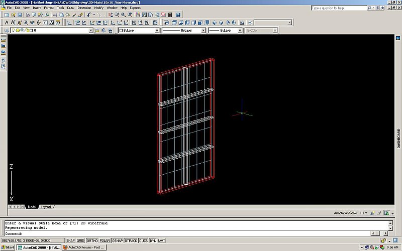

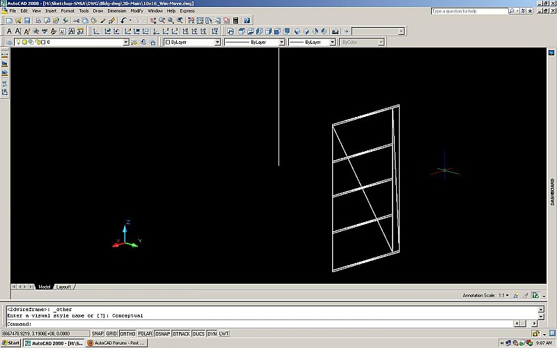

Rene Posted April 28, 2010 Share Posted April 28, 2010 I have issues when working with Visual Styles.Solids not Displaying in Comceptual or Realistic View in Visual Styles Mode. when i move model to new Location. it displays Correctly in orginal postion. But when i move to New Location solid are not displaying in Visual Styles Conceptual or Realistic Mode. Quote Link to comment Share on other sites More sharing options...

Rene Posted April 28, 2010 Author Share Posted April 28, 2010 V.S is working find , it's when i move the model to new location is it starts acting up. computer specs: OS Name Microsoft Windows XP Professional Version 5.1.2600 Service Pack 3 Build 2600 System Manufacturer Hewlett-Packard System Model HP Z400 Workstation System Type X86-based PC Processor x86 Family 6 Model 26 Stepping 5 GenuineIntel ~2400 Mhz BIOS Version/Date Hewlett-Packard 786G3 v01.17, 8/19/2009 SMBIOS Version 2.6 Quote Link to comment Share on other sites More sharing options...

Rene Posted April 28, 2010 Author Share Posted April 28, 2010 Visual Styles works Fine, it is when i move model to new Location. Model Base point Orgin is Moving to when move to this Location it's not displaying model solid fills. using Autocad 2008 Ram info & Display info Total Physical Memory 4,098.00 MB Available Physical Memory 2.51 GB Total Virtual Memory 2.00 GB Available Virtual Memory 1.96 GB Name NVIDIA Quadro NVS 295 PNP Device ID PCI\VEN_10DE&DEV_06FD&SUBSYS_062E10DE&REV_A1\4&F56E37E&0&0018 Adapter Type Quadro NVS 295, NVIDIA compatible Adapter Description NVIDIA Quadro NVS 295 Adapter RAM 256.00 MB (268,435,456 bytes) Installed Drivers nv4_disp.dll Driver Version Not Available INF File oem9.inf (nv4_G98_DualView_NVS section) Color Planes 1 Color Table Entries 4294967296 Resolution 1440 x 900 x 60 hertz Bits/Pixel 32 Memory Address 0xE2000000-0xE2FFFFFF Memory Address 0xD0000000-0xE3FFFFFF Memory Address 0xE0000000-0xE2FFFFFF I/O Port 0x0000E000-0x0000EFFF IRQ Channel IRQ 24 I/O Port 0x000003B0-0x000003DF I/O Port 0x000003C0-0x000003DF Memory Address 0xA0000-0xBFFFF Driver c:\windows\system32\drivers\nv4_mini.sys (6.14.11.8274, 5.99 MB (6,285,664 bytes), 7/2/2009 3:08 PM) Name DameWare Development Mirror Driver PNP Device ID ROOT\DISPLAY\0000 Adapter Type Not Available Adapter Description DameWare Development Adapter RAM Not Available Installed Drivers Not Available Driver Version Not Available INF File Not Available Color Planes oem12.inf Color Table Entries DwMirror Resolution Not Available Bits/Pixel Not Available Driver c:\windows\system32\drivers\damewaremini.sys (1.1.0.0, 3.63 KB (3,712 bytes), 2/7/2007 2:00 AM) Quote Link to comment Share on other sites More sharing options...
ReMark Posted April 28, 2010 Share Posted April 28, 2010 Does the problem only occur in this one drawing or in every 3D drawing? Virtual memory seems low for a system with 2.5GB of available memory. I would also expect available memory to be a tad higher in a system with 4GB installed. Are you running with the 3GB switch enabled in your boot.ini file? Quote Link to comment Share on other sites More sharing options...

ReMark Posted April 28, 2010 Share Posted April 28, 2010 And has this always been the case since you first started using 2007 or did it suddenly happen overnight? Are you current with all service packs for AutoCAD 2007? Have you made any changes to the graphics card recently? Maybe update a driver? Ahhh...the light. I had a similar problem that turned out to be graphics card related. However, at the time it was an AGP card with only 128MB of vidRAM on it. The darn thing couldn't handle some of my more complex 3D drawings. Quote Link to comment Share on other sites More sharing options...
Rene Posted April 29, 2010 Author Share Posted April 29, 2010 Just Recently Start Working on 3d Models. IT Upgrade System to handle 3d Work, will need to check w/them Graphics Card. Quote Link to comment Share on other sites More sharing options...
ReMark Posted April 29, 2010 Share Posted April 29, 2010 I'd check to see if you have the latest driver. Quote Link to comment Share on other sites More sharing options...
