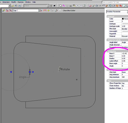

dbroada Posted August 26, 2008 Posted August 26, 2008 basically your rotation parameter wasn't placed at 0,0. try this Chair-1.dwg Quote
bert Posted August 26, 2008 Author Posted August 26, 2008 Thanks for the response. So does that mean that even though you set a point for the rotation parameter it doesn't recognize that point but defaults to 0,0? Seems strange. Does this mean that for all my existing blocks I have to move all of them so that the spot I want as the center of rotation is at 0,0? Quote
dbroada Posted August 26, 2008 Posted August 26, 2008 Thanks for the response. So does that mean that even though you set a point for the rotation parameter it doesn't recognize that point but defaults to 0,0? Seems strange. No, it goes where you put it. You had placed the rotation parameter at something like -12,0 Quote

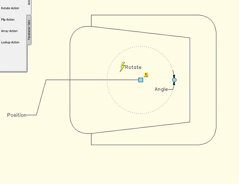

dbroada Posted August 27, 2008 Posted August 27, 2008 check my screen shot, you will see that the centre of your rotate parameter is not in the centre of the chair Quote
bert Posted August 27, 2008 Author Posted August 27, 2008 But on mine it shows different. See my attached screenshot. I wonder what I'm doing wrong? Quote
dbroada Posted August 27, 2008 Posted August 27, 2008 at least that shows where the problem is - but I don't have an answer Quote
bert Posted August 27, 2008 Author Posted August 27, 2008 I moved the chair to 0,0 and recreated the Parameter and Action. Everything worked then. I thank-you for your patience and time spent helping me with this. Quote
