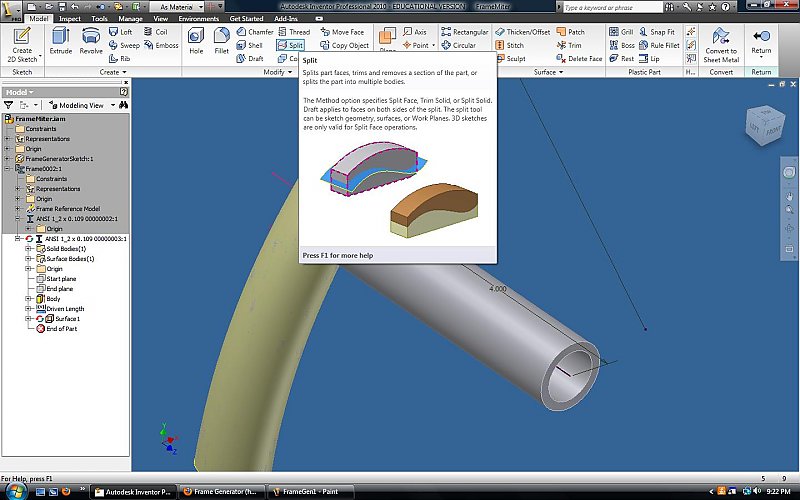

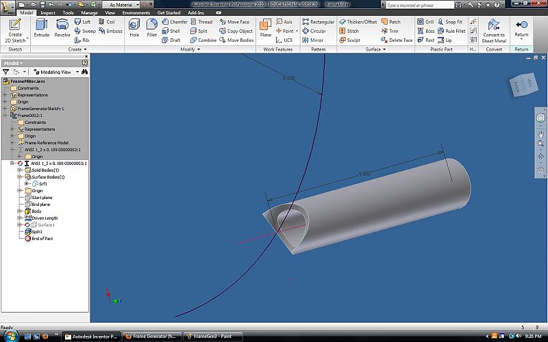

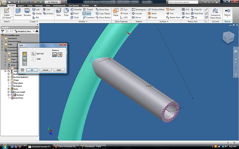

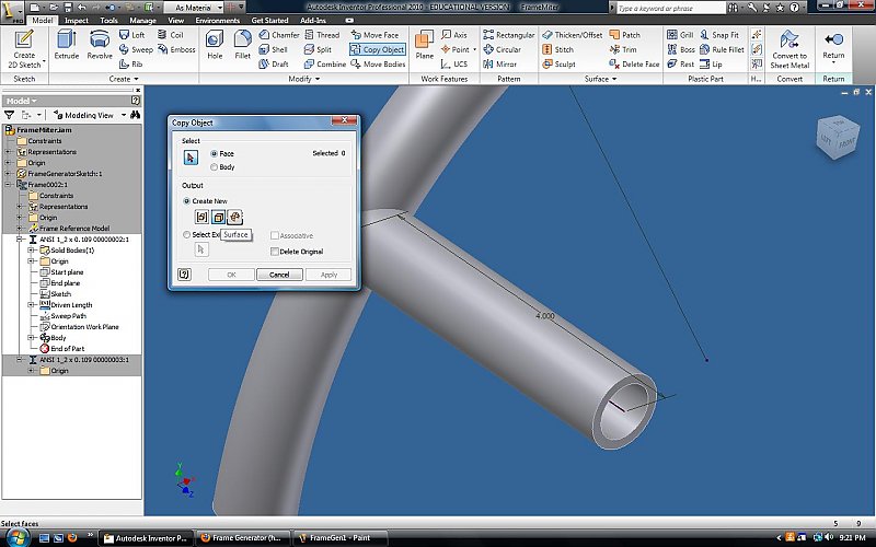

shift1313 Posted May 1, 2010 Share Posted May 1, 2010 Here are some pics for you Arshavin with a little explanation. First I created two frame members real quick that were similar to what you are working with. Next I selected the short member and go into Edit mode. Select Copy Object in the modify section of the Model tab. Pay attention to the options you have on the Copy Object dialog box. I select Face. Under the Output section I "create new" and select Surface(center box). Make sure the Delete Original box is not checked. What you have just done is create a surface that is identical to the outside face of your arced tube. Next I use the split tool, again in the modify section of the Model tab. On the split dialog you have a few options. Split face, trim solid and split solid. In this case(since you dont need the part of the tube we are cutting) select the second box down which is trim solid. Your split tool will be that new face we just created with the Copy Object dialog. Since there is only one solid body in this frame member the "solid" box will not be selectable. If you were dealing with multi body parts you would be able to select the solid you wish to remove from. Pay close attention to the direction of the red arrow that pops up on the screen. In my image it is pointing the wrong way. The Remove section allows you to pick the direction. Everything from your surface in the direction of the arrow will be removed. And thats it! in the last picture i just turned the visibility off of the arced member so you could see the cut. Quote Link to comment Share on other sites More sharing options...
