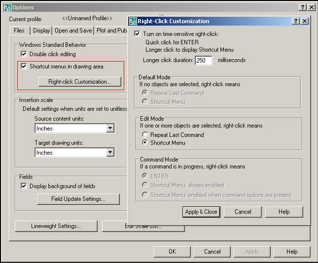

Right-click customization under Options...

You're quite welcome. However, I can't imagine going back to the days before the right-click menu.
Not 100% sure what you're referring to, but be sure to uncheck the Turn on time sensitive right-click.

Once the right-click menu came out, I learned to use the spacebar (same as enter and my left hand rarely leaves the keyboard) as a replacement. That way I could have the best of both worlds (the above image shows my exact settings).
