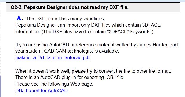

omelet Posted January 15, 2015 Posted January 15, 2015 i have same problem too, i already explode, convert to surface but it still not working to open dxf file to pepakura design is dxf file from autocad can't open in pepakura? Quote
ReMark Posted January 15, 2015 Posted January 15, 2015 Did you visit the Peparuka website and see this? Quote
