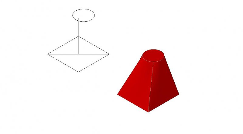

I'm working on this shape:
it has square base, goes to the top round , and round top is shiffted off center. Please help

Sounds like the LOFT command would be your best bet.

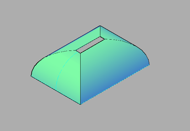

Yes, an arc can be swept around a rectangle. You may not like the result though.
An arc swept around a rectangle.

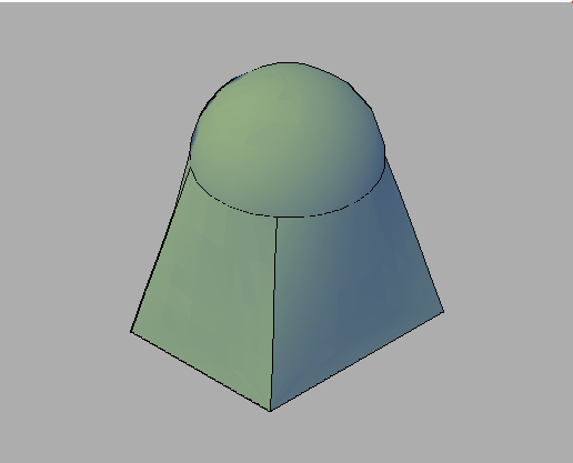

No, your right I dont want a surface, I want a solid. I want pretty much the same exact thing you showed an example of previously, except I need the top to be domed or spherical. The flat circle wont work for this application.
Maybe I should try adding a sphere to a cone shape with a rectangular base?
Looks odd to me but if it works for you that's ok.
You right that does look odd, prob wont work.... I tried making a sphere, cutting off the bottom and manipulating it a little. This is as close as I can get to what I want.....
