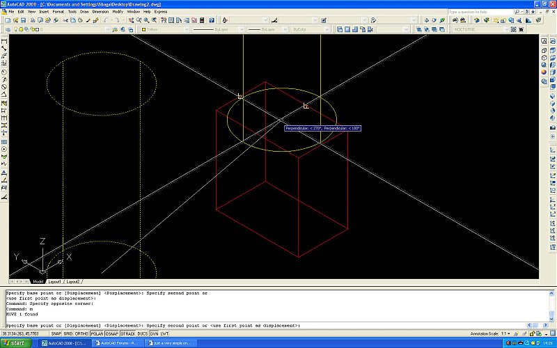

Hi All,
I've got a simple problem here, I put my question on the attached file.

toggle ONSNAP Settings, check CENTER and MIDPOINT.
toggle also ONTRACK on.
>move> select bottom center of cylinder,
move the crosshair close to the midpoints of at least 2 sides of the upper face of the cube to activate a ghost track shown in dotted lines, then just click to where the 2 ghost lines from the 2 midpoints intersect.
errr,,i hope its clear... ill just post a screen
you put it in centre I knew that I want to move it in a exact position as it is just on z axis direction not centralize them. but anyway thank u for reply.

Try:
With Osnaps End & Center set, start the Move command.
At the Specify base point or [Displacement] : prompt select the bottom center of the cylinder.
At Specify second point or : prompt type .XY
Then @
Then select any top corner of the box.
many thanks really helpful,
Cheers

Incidentally, if further background on this process is needed search the help files for “Point Filters” or “Coordinate Filters”.
"how can I move the bottom face of the cylider on z axis and put it on the top face of the box?" was your actual question. You may want to reiterate the question in the dwg file to get more precise results
